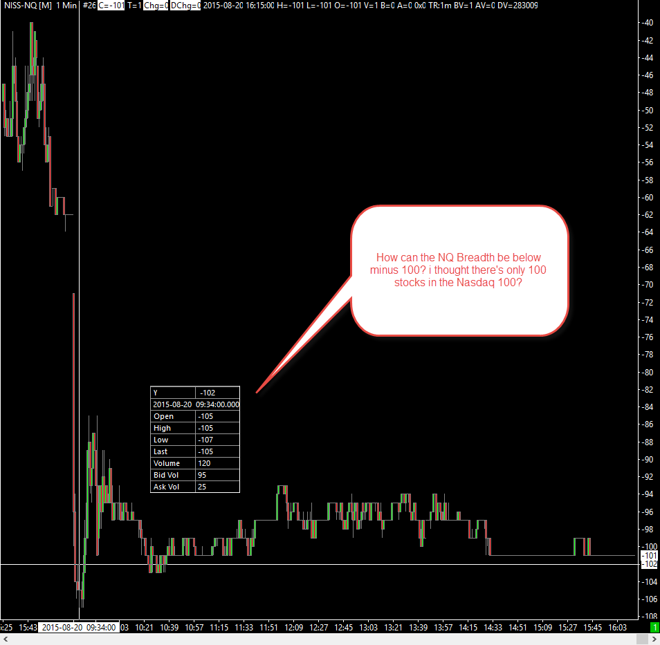

Hello Support,
could you please shed some light onto this? afaik there's only 100 stocks in NDX, how can the adv-dec be lower then minus 100?
thanks,
Andreas

[2015-08-20 20:30:02]
Cavalry3162 - Posts: 523
bonus question (after taking another look at the screenshot):
how could it be that the index does have a bid and ask volume?
[2015-08-20 22:28:33]
We will check on this.
There is bid volume and ask volume because that is always recorded by our systems. In this case it is going to represent up ticks and down ticks.
[2015-08-21 02:12:35]
This is the official answer about this:
The SP, NQ, and YM indexes are reliant on the Barchart web interface to get the components of the index. They are not always up to date. We request these each day, but some days they have 102 others it may be back to 100. It just depends when Barchart updates their list.

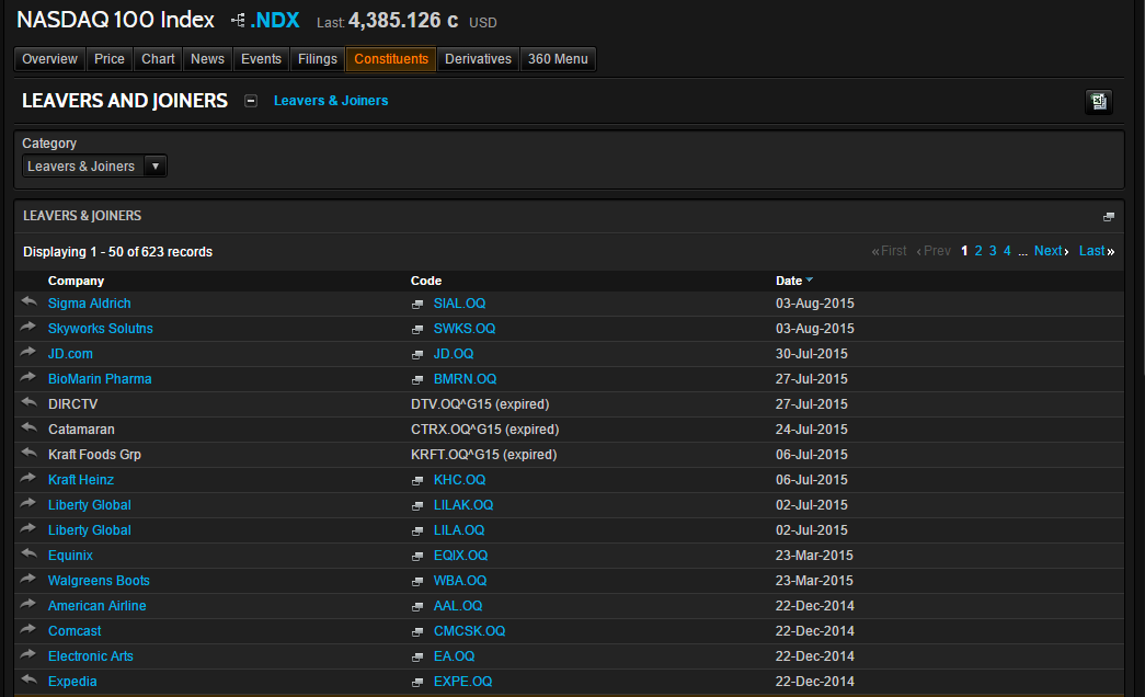

thanks for the info, but this doesnt really sounds great. as you can see in the screenshot attached, the last update on the NDX was almost 3 weeks ago. barchart doesnt look too reliable here.
maybe you could advise them to do better?
thanks,
Andreas
