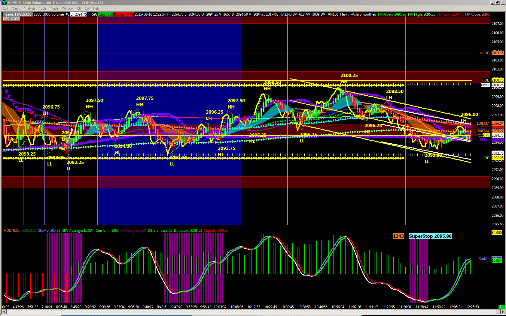

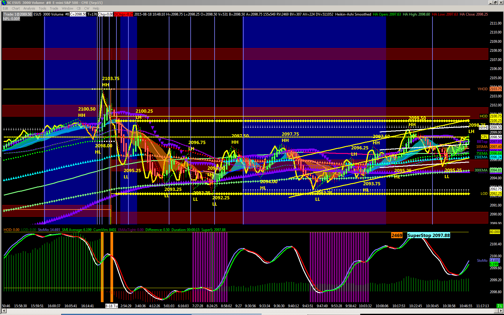

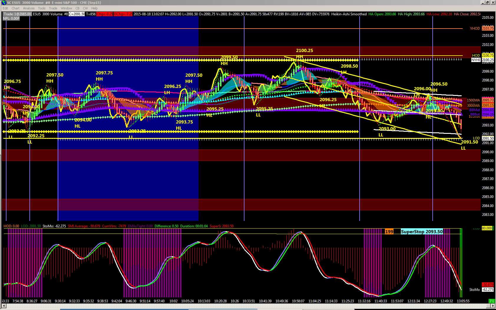

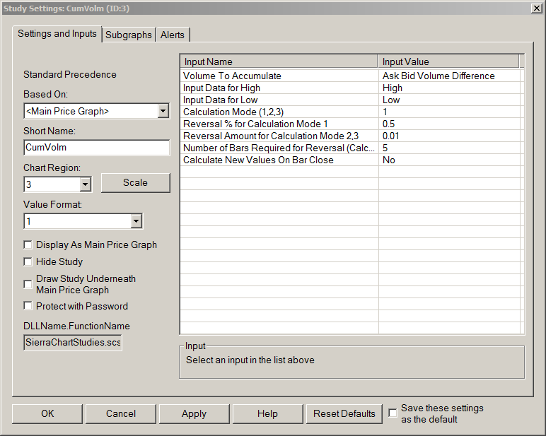

[2015-08-18 17:15:19]
djcurcio - Posts: 236
OK - here are some screen shots for today 0818. Note that the Cim Vol bars that were green in the earlier time charts were all repainted red when a new LOD was hit at 2091.50 at 1302 edt.
Note that the reverse repaint also occurs if a new HOD occurs, changing the previous red bars to green.
I do not believe this is correct. And it is certainly misleading.
imagesierra vol bar 08182015 settings 2.PNG / V - Attached On 2015-08-18 17:11:56 UTC - Size: 39.33 KB - 529 views
imagesierra vol bar 08182015 settings 1.PNG / V - Attached On 2015-08-18 17:12:14 UTC - Size: 35.89 KB - 499 views
imagesierra vol bar 08182015 0847 edt.PNG / V - Attached On 2015-08-18 17:12:43 UTC - Size: 190.15 KB - 510 views
imagesierra vol bar 081820151048 edt.PNG / V - Attached On 2015-08-18 17:13:08 UTC - Size: 182.1 KB - 517 views
imagesierra vol bar 08182015 1223pm edt.PNG / V - Attached On 2015-08-18 17:13:27 UTC - Size: 155.78 KB - 454 views
imagesierra vol bar 08182015 1302pm edt.PNG / V - Attached On 2015-08-18 17:14:06 UTC - Size: 170.18 KB - 526 views
[2015-09-03 10:48:07]
I misidentified the indicator - it is thew Zig Zag Cumulative Volume.
It repaints all the bars back if a new HOD or LOD is hit.
Please review - I think this is bug.
I do not believe there should be any repainting of the bar colors.
See the pics posted.
