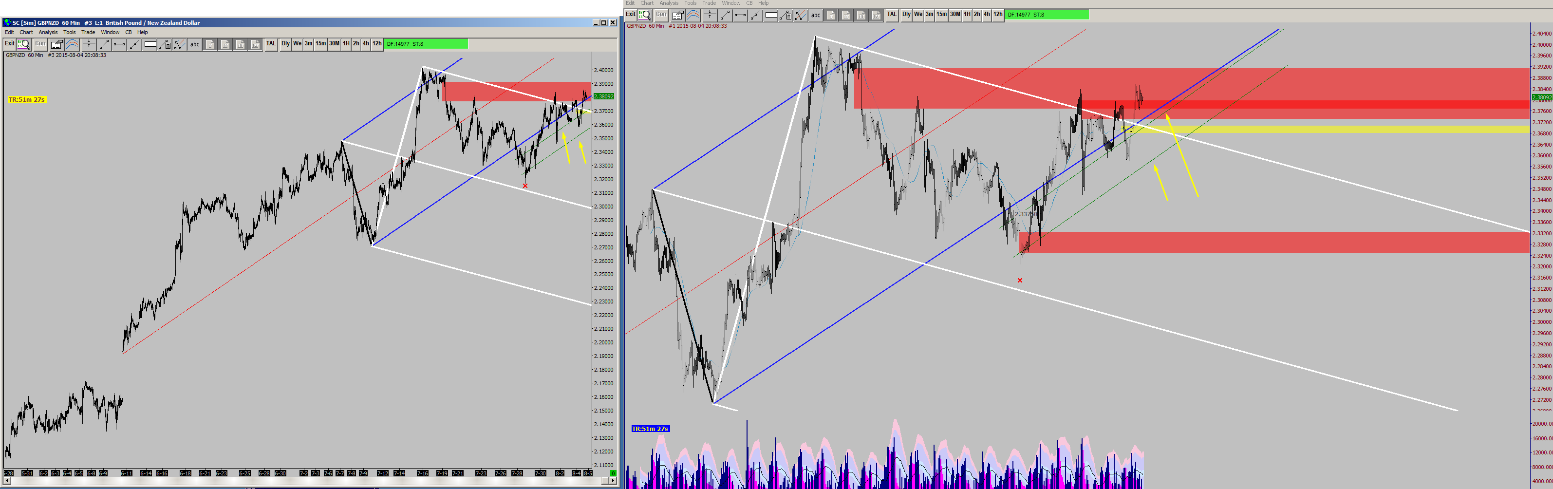

Here is a picture of what I'm wondering. I have a blue line on the original chart on the left and the same blue line on the other chart price is much further from it. Both are 60m, same symbol and zooming in/out doesn't make a difference. Why is this? I find it all over my charts. If this chart is too garbled I can upload a cleaner one...

Is the starting Date and Time the same between these two charts?
[2015-08-05 00:37:59]
Hieronymus - Posts: 51
Yes, I checked that also. Same in all.

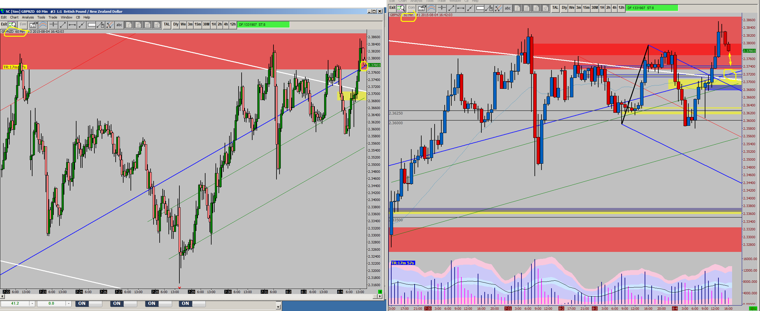

Here are two more pictures showing it a bit more clear. Notice the green lines are not even parallel on the second chart. The only difference of the charts is the number of days loaded.

The number of days loaded in the charts may make a difference depending upon the starting Date-Time of the line. Make them the same.
For more information about this problem and how to solve it, refer to these two sections here:
https://www.sierrachart.com/index.php?page=doc/helpdetails34.html#ChartDrawingMapping
