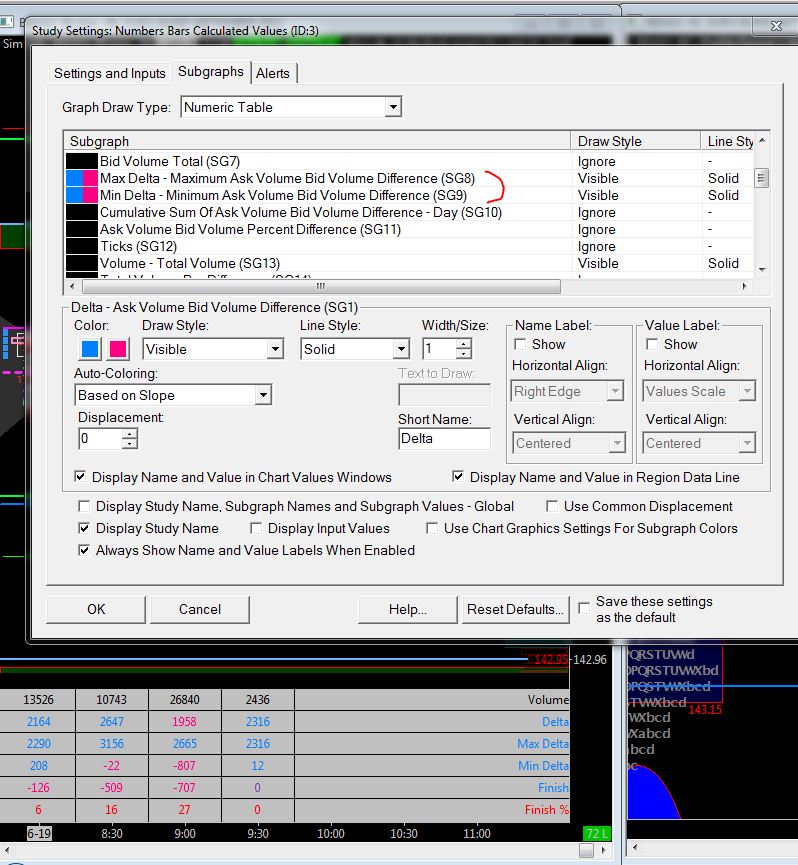

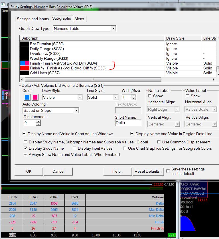

i'm using :
Volume
Delta
MaxDelta (maximum ask volumes bid volume difference)
MinDelta (minimum ask volumes bid volume difference)
Finish (finish askvol bidvol diff)
Finish % (finish askvol bidvol diff %)

PS:i show you my settings
imagesettings.JPG / V - Attached On 2013-06-19 07:40:06 UTC - Size: 156.89 KB - 857 views
imagesetting2.JPG / V - Attached On 2013-06-19 07:40:15 UTC - Size: 147.49 KB - 799 views
