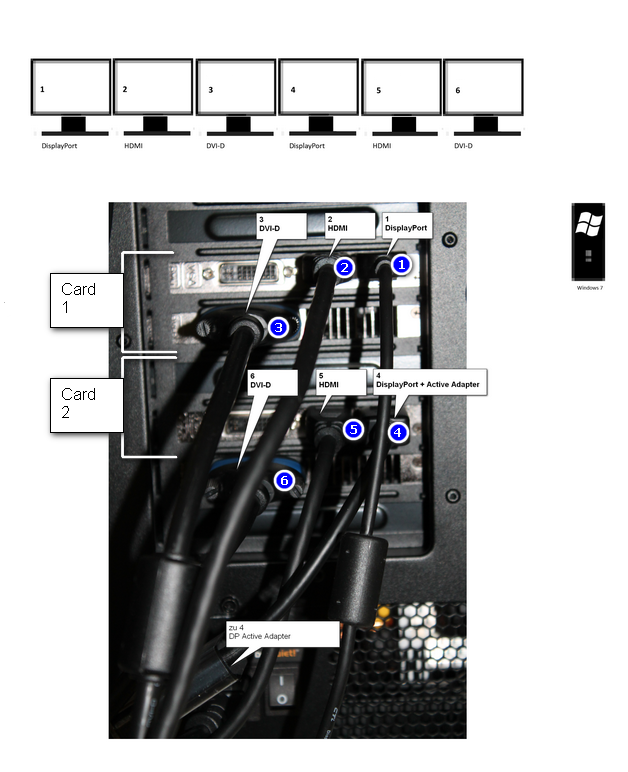

Starting with the graphics card closest to the mainboard (in most cases the most upper graphics card) connect the most recent (means: technically the most modern) connector to the physically first monitor and keep this order of most recent (most modern) connectors:
newest ----------------------------> oldest
DisplayPort > HDMI > DVI-I > DVI-D > VGA (D-Sub).
Refer to the attached illustration.

Start connecting the second graphics card with the most recent connector as you did with the first graphics card (refer to the attached illustration).
