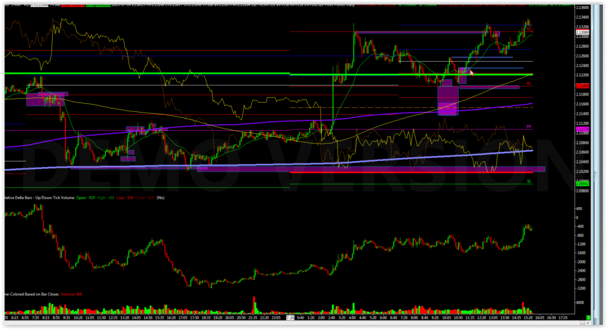

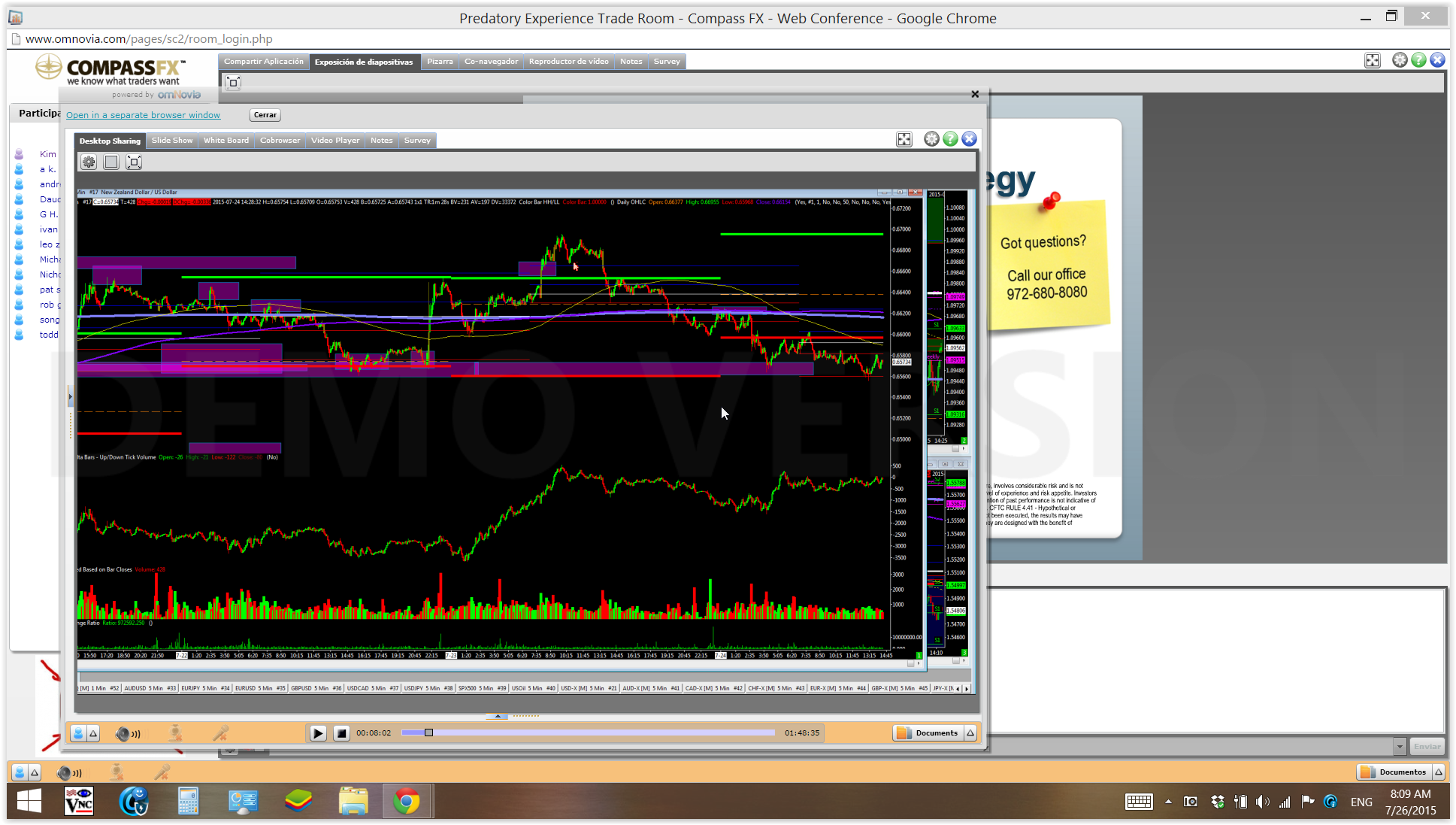

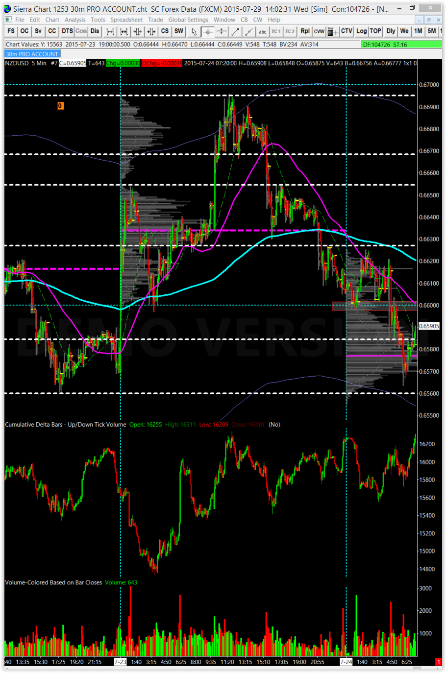

1 - Why do I keep getting such a discrepancy in Cumulative Delta Bars - Up/Down Tick Volume indicator btw my own charts and those from another trader, who also happens to be my mentor and is involved with compassfx teaching us. Please find attached my chart vs his on NZDUSD and GBPAUD. The Cumulative Delta Bars - Up/Down Tick Volume divergence gets to a ridiculous point.
2 - I trade only spot FX. Is there any other data feed, other than the current one I use - SC Forex Data (FXCM) - which may provide more reliable Cumulative Delta Bars - Up/Down Tick Volume, as I keep observing these discrepancies over and over... especially at the close of NY, when there are usually huge spikes in Cumulative Delta Bars - Up/Down Tick Volume with spot price not moving at all... (that doesn't occur with the charts of our mentor).

1. This particular study is very sensitive to differences under certain conditions. It would be good if your mentor does not use this study because this kind of problem is inevitable. They should instead use Cumulative Delta Bars-Volume.
We cannot precisely explain why you see the differences because we have no 100% confirmation as to the settings the mentor is using.
The reasons for this problem are described in this section here:
https://www.sierrachart.com/index.php?page=doc/doc_TechnicalStudiesReference.html#CDBDifferences
Do they have Sierra Chart set for a tick by tick data configuration? If not, then this problem is 100% guaranteed to occur. Also if the precise starting date and time is different between the two charts, there will be differences.
2. The data feed will not matter. So there is no recommendation here. This can occur with any data feed. However, we are not aware of a problem as long as the starting date-time in the chart is consistent and there is a tick by tick data configuration.
