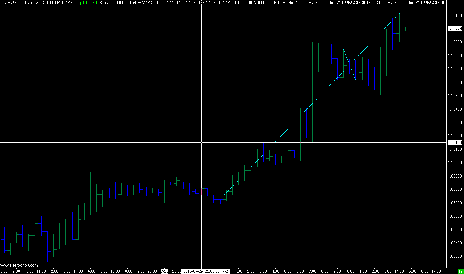

I am trying to draw a Pitchfork from ACSIL but it is not drawing the upper and lower lines, as shown in the chart image.
http://www.sierrachart.com/image.php?l=1438015103896.png
Here is the code I have written. Can you tell me what's wrong?

[2015-07-28 01:34:55]
Here is a good working example we put together:
