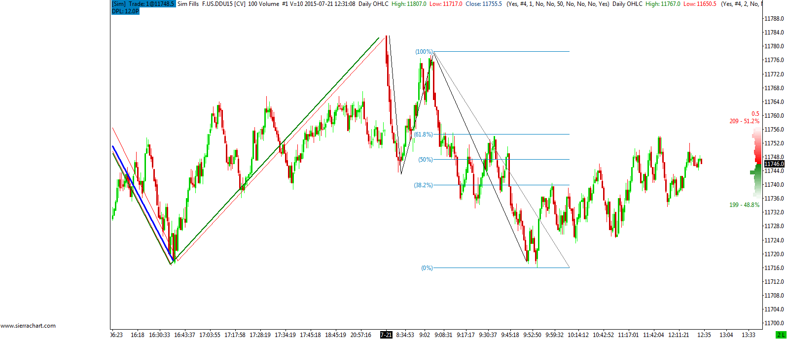

here ist the image.
http://www.sierrachart.com/image.php?l=1437474694146.png

[2015-07-21 10:56:08]
Make sure the Daily OHLC study Subgraphs are set to a visible Draw Style.
What are the Session Times of the chart in Chart >> Chart Settings?
Also remove other Daily OHLC studies on that chart so not to create further confusion until the problem is isolated.

[2015-07-21 11:11:17]
The chart clearly shows a second Daily OHLC study.

[2015-07-21 11:40:42]
This kind of problem report is very unusual. And we did see the problem and it puzzled us for a while, but then realized there must be some problem with the main price graph scale.
The problem is that you set the main price graph in Chart >> Chart Settings >> Scale to use an Independent scale. It must be Automatic.
Also, the chart contained 4 Daily OHLC studies.
