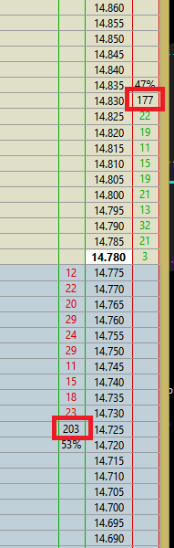

Hi - I am registered user of SC.
I have attached the screenshot of a DOM where Total BID Qty is 203 & Total ASK Qty is 177. I just want to plot Total BID Qty - Total ASK Qty = 26! Preferably as a continuous line graph or just like Cumulative Delta is plotted! For e.g. if I chose 1sec TF, there would a different number plotted. It can also have -ve values with 0 as a reference line!
Am I missing this study in the study collection as I didn't find it in the collection and through search board! Please help and if not already available please add it in the next release as this is a very simple (just need to calculate A-B and plot!!) yet powerful study for Auction Market Theory followers!
Thanks!

imageneed to plot BUY-SELL.png / V - Attached On 2015-07-20 17:32:54 UTC - Size: 10.01 KB - 712 views

I have seen that study earlier too. But it's not exactly what I mentioned in my initial post because:
1). According to definition in "technical studies" for Bid & Ask Depth Bars study-: Total Bid Depth and Total Ask Depth are calculated every time there is a change with Market Depth at the best Bid and Ask level ONLY. Actually, I want the difference/ratio whenever there is any change on any level above or below. ONLY change at best bid/ask doesnt give the true picture of the underlying demand and overhead supply.
2). In case of difference too, it's ONLY "Total Ask Depth - Total Bid Depth". Please add "Total Bid Depth - Total Ask Depth" too!
Believe me this is a very important study which is used by order flow traders worldwide! Implementation wise its easy with few lines of codes. In Fact, you already have similar study! Either you can add to it what I mentioned above and make it a separate study or in the same study you can add option of "change on any bid/ask level" or "change in best bid/ask level"
Thanks in advance!

1. Really, we think this is sufficient because often when there is a change at one market depth level the best levels are changing as well. Using too fast of an update frequency will use a significant amount of more memory. There will be a significant consequence for us to change this unless it were an option.
2. We are adding this now:
[2015-07-27 20:35:47]

I believe there is a confusion! Can you please explain how this "update frequency" which you mentioned has anything to do with this study! Infact, in the DOM its already getting updated every time there is a change in any level above or below. Its getting updated every second or less than a second! I am just asking for its graphic representation i.e. chart. Thats it!
As you knowingly/unknowingly said it rightly that "when there is a change at one market depth level the best levels are changing as well". But the study only plots when there is a change with Market Depth at the best Bid and Ask level ONLY!
So to chart what you said in your opening sentence, I need to have Total Bid Depth (all bid levels) & Total Ask Depth (all ask levels) then only this study is of any use. So in current study the Total Bid & Ask Depth (only if best bid & ask changes) gives a wrong picture as far as the order flow is concerned!
Moreover, as I have already said it before- the Total Ask Depth & Total Bid Depth are already getting updated in the DOM and there is no need to reinvent the wheel. You just have to add an study where its getting graphically represented with the same option/calculation mode/input value given in existing study (Bid & Ask Depth Bars)
Either you can add to it what I mentioned above and make it a separate study or in the same study you can define Total Bid Depth & Total Ask Depth with 2 options each:
1-Total Bid Depth as a)change at best bid b)change at all bid levels
2-Total Ask Depth as a)change at best ask b)change at all ask levels
Please let me know if there is still any confusion!
Date Time Of Last Edit: 2015-07-27 20:45:16
[2015-07-29 01:32:05]
There definitely is no confusion. We understand what you want.
This is from the documentation for this study:
Total Bid Depth and Total Ask Depth are calculated every time there is a change with Market Depth at the best Bid and Ask level only. This includes either the prices or quantities. This creates a snapshot of Total Bid Depth and Total Ask Depth at that moment in time. The snapshots are then used in the formulas.
It is not possible for us to change how this works. And we cannot change how the study works to calculate this data because that would be too limiting and give you less accuracy.
This is all we can offer. It will not help to try to get more out of us. We just cannot accommodate this without complications.
