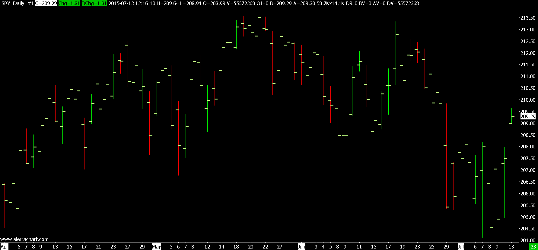

We have looked at a chart of SPY using IQ Feed and this is what we currently see:
http://www.sierrachart.com/image.php?l=1436808672965.png
If your SPY chart looks the same, and it should because we already compared it to the Sierra Chart data feed, then the data is correct.
