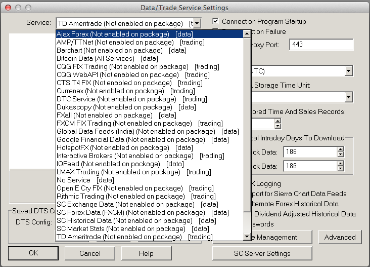

The install went without any issue using Wine/Winebottler, however when I go to setup the Data/Trade Service all of the service options say (Not Enabled on Package)
Is there something I can do to correct this?
I am using an active Trial account.
Thanks in Advance!
Date Time Of Last Edit: 2015-07-04 01:43:15
imageScreen Shot 2015-07-03 at 9.31.04 PM.png / V - Attached On 2015-07-04 01:40:13 UTC - Size: 51.81 KB - 523 views
[2015-07-04 04:06:32]
Your account has been activated and/or reset.
A restart is necessary if Sierra Chart is already running. Exit the Sierra Chart charting and trading software by selecting "File >> Exit". Open Sierra Chart through the icon on your desktop or through the desktop Start menu.
After your Sierra Chart usage time ends, you need to pay for additional usage time through "Help >> Add Usage Credit".

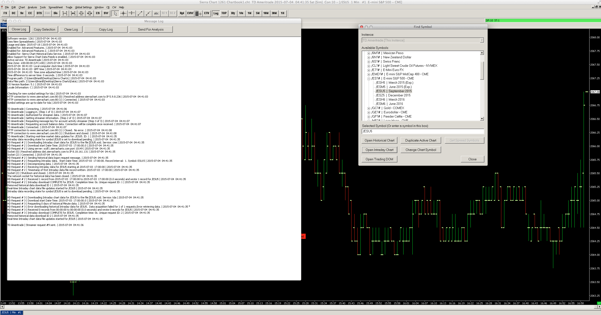

After I'm connected, I "Find Symbol", navigate to load /ESU5 and click Load Intraday Chart, it loads partially and fails, all the windows freeze and force quit is needed.
I do appreciate the help as I realize I'm trying to use SC outside its original intent. I love the software and do plan on using it, I would just like to verify if a Mac is an option or not.
Attached is a SS with error message .
imageScreen Shot 2015-07-04 at 12.48.52 AM.png / V - Attached On 2015-07-04 04:58:20 UTC - Size: 200.09 KB - 453 views
[2015-07-04 20:22:43]
We believe the problem is with WINE and the use of the HTTP functions within WINE and that is what is causing the problem described here:
Longer-term we will solve this by bypassing those functions within WINE but we are not sure when.
