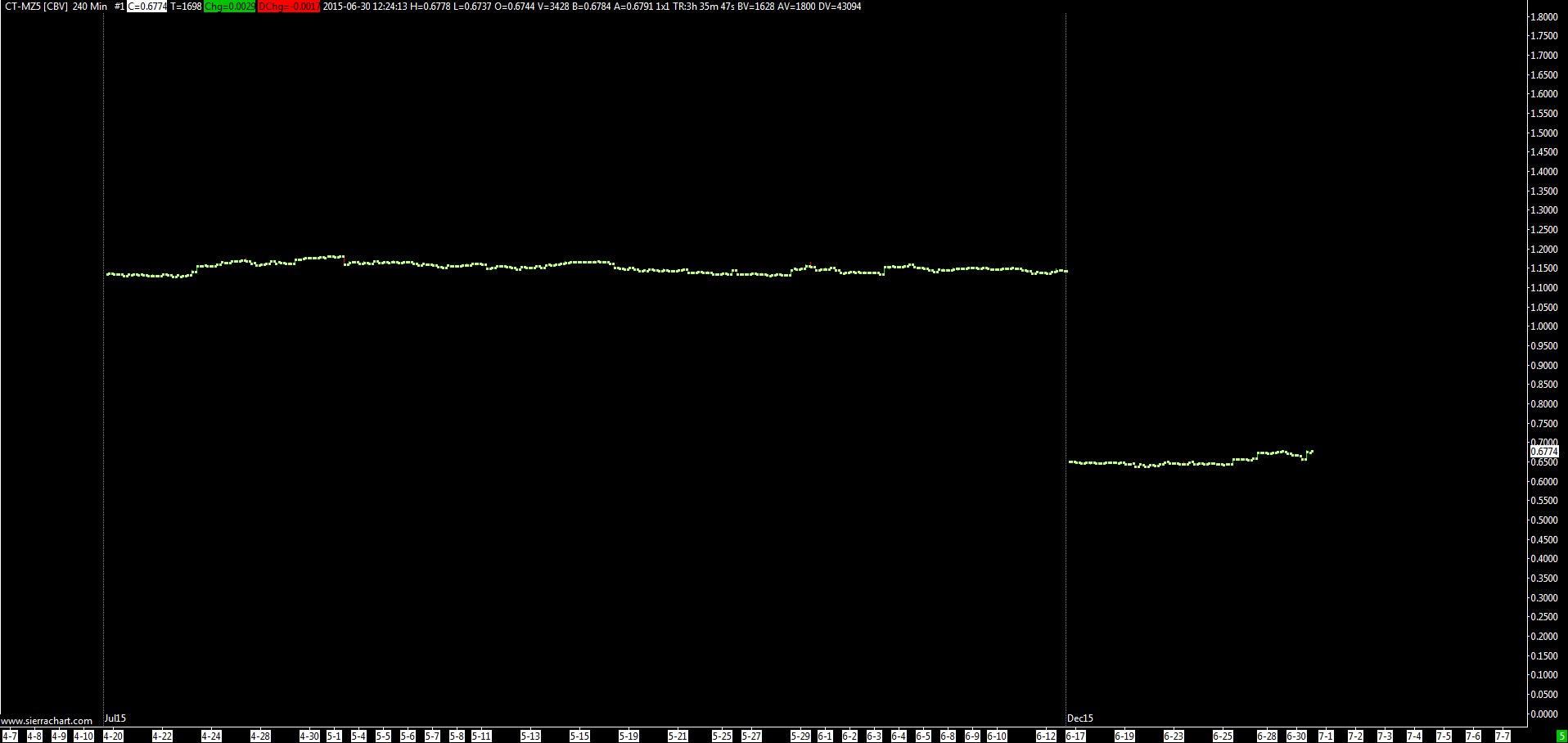

Interesting. Those steps worked for SB, but not CT. http://www.sierrachart.com/image.php?l=1435691435725.png

You need to re-download the data for the July Cotton contract. Here are instructions:
http://www.sierrachart.com/index.php?page=doc/doc_ContinuousFuturesContractCharts.html#ReDownloading
If you need more help, we can use remote assistance to re-download the data for that particular month, because there should not be anything further that needs to be done. This should be very straightforward to solve.
Date Time Of Last Edit: 2015-06-30 20:28:18
