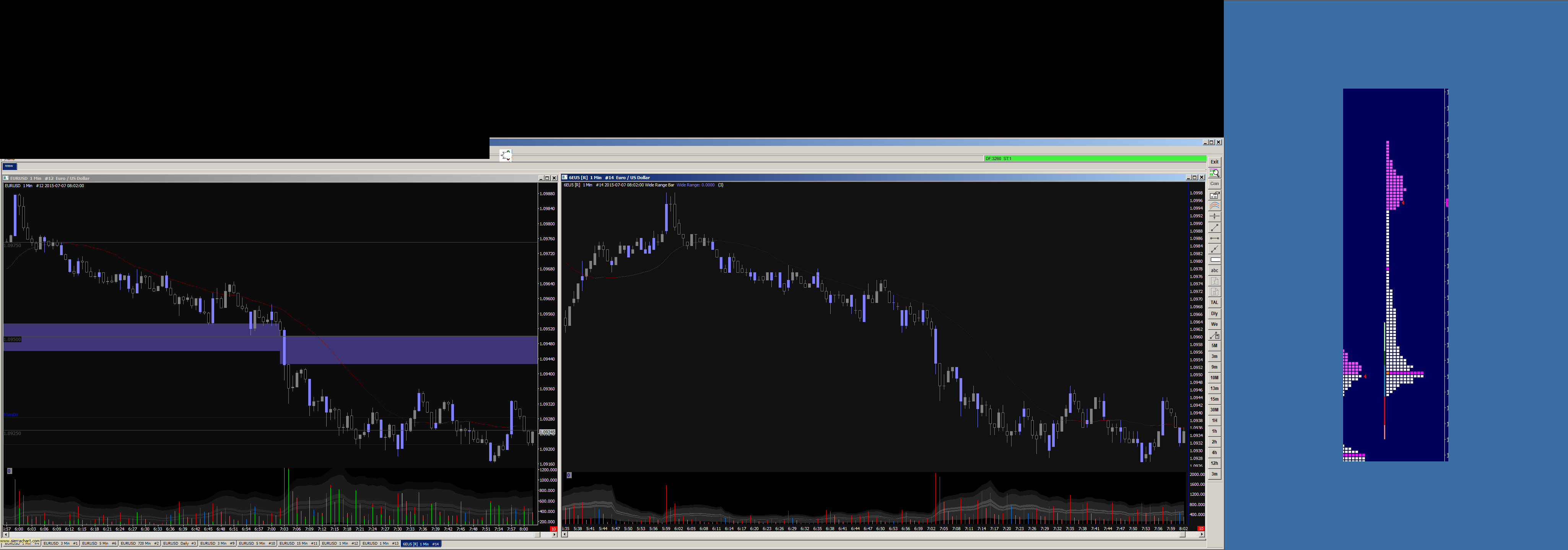

I've gotten everything figured out, except how to share an the specific volume indicator I use. The chart on the right is sharing its futures volume data with the one on the left, as per the lime-green bars but how can I share the actual volume study as well?
http://www.sierrachart.com/image.php?l=1436313748161.png

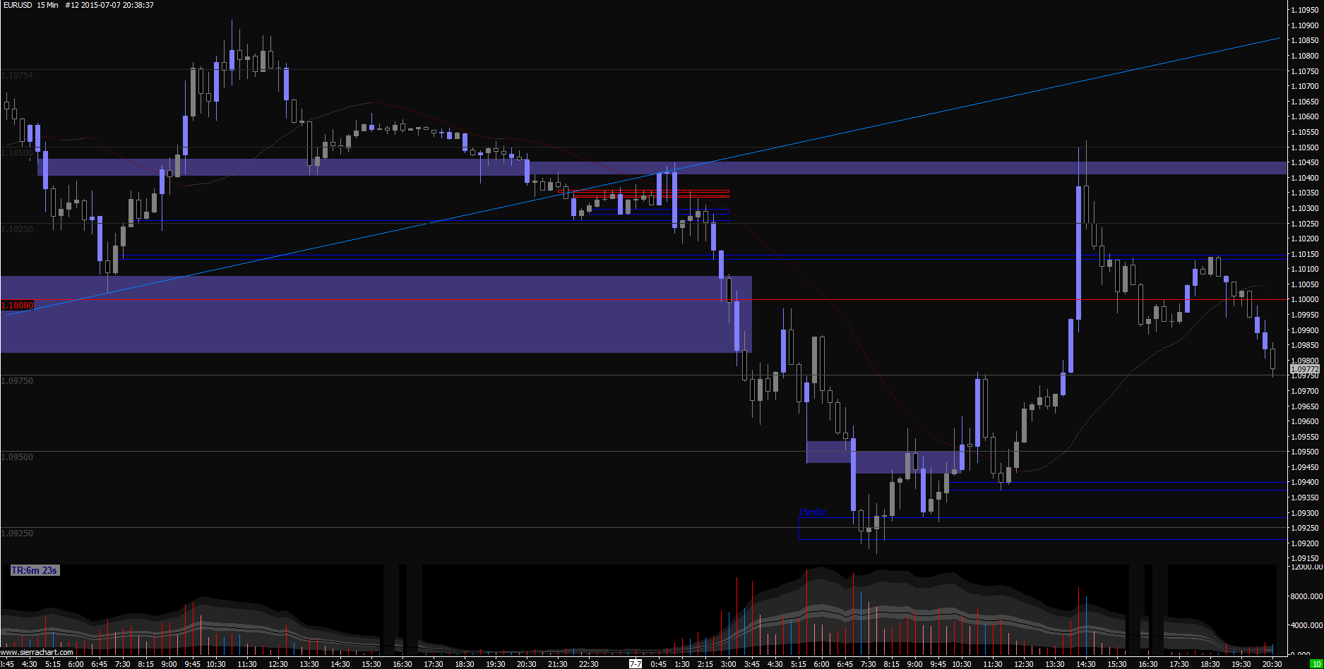

It does however leave some gap like graphics, but doesn't effect the data, is this normal or is there a way to fix this? You can see it in the volume, the gap/smudge areas.
http://www.sierrachart.com/image.php?l=1436319522558.png
Date Time Of Last Edit: 2015-07-08 01:41:06
[2015-07-08 03:20:55]
We are not exactly sure what you are referring to and it is extremely hard for us to comment on this because we really do not understand exactly what you are doing and why everything appears the way it does.
[2015-07-08 03:36:51]
Hieronymus - Posts: 51
No problem, I don't think it's something that can be fixed. I believe it's just from the futures market close each day.
