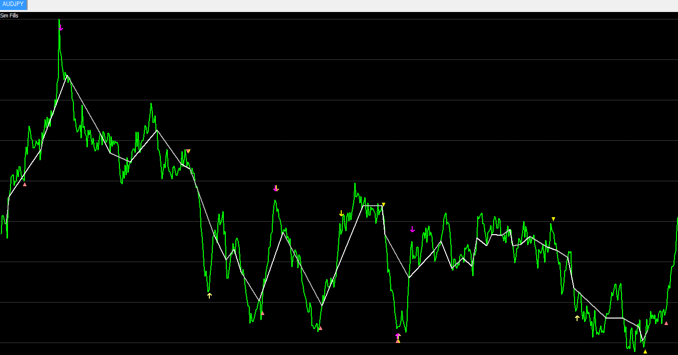

ticktrader - Posts: 5
Here is a picture of what I see. The yellow or pink arrows are projection of the sending chart onto the receiving chart.
image6-7-2013 12-54-58 AM.png / V - Attached On 2013-06-07 04:56:04 UTC - Size: 17.92 KB - 876 views

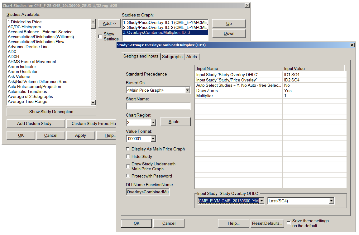

TastyRisk - Posts: 119
Try this: it will combine the data from two studies.
I made it to use the open of study#1, and the "fill blank" data from study#2. This is the choice in "auto mode"; but if you choose "N= non auto select" in the settings; then you can combine your two overlays which each have different settings.
It might work for you?... It will try to use the data from study #1. If that data array is empty then it will take the data from study #2. For sure you must "fill blanks" on your second input study.
See picture below about study #1 & study #2.

Date Time Of Last Edit: 2013-06-12 06:16:36
[2013-06-12 06:04:57]
see pic for settings.
imageexample564fd168vt48.png / V - Attached On 2013-06-12 06:04:40 UTC - Size: 63.01 KB - 797 views
I think you should take another look at my custom study.
Yes, it will use study data from another chart...
You need to overlay the same study twice before adding my custom study.
The first overlay will contain your "Use Earliest Value from ..." data.
The second overlay will contain your "Use Latest Value from ..." data.
My custom study, provided in code already, will then read data from the two overlays. It will always fill the blanks if no value exists in the first study. Perhaps you'd want the first study set to "latest" and second to "earliest" depending on your usage.
It's working for me although glitchs do occur on sub-second overlayed arrays but that's not something that can be fixed without a change in how SC time-stamps data.
