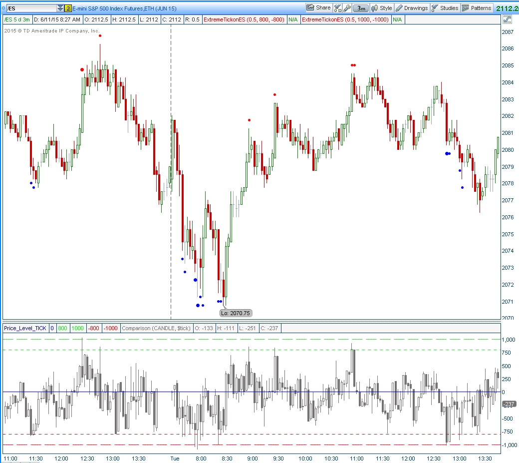

I need help with a study for plotting where extreme ticks are on the chart. I know I can overly the tick below my chart but what I want is just to plot extreme moves on my chart such as +800, +1,000 ... etc.
I have this coded in thinkorswim but now am looking to code it into Sierra. See attached screenshot from thinkorswim for what I am hoping this to look like. A dot gets plotted when the Tick goes to an extreme level. The more extreme the level the larger the dot.
Any help would be appreciated.

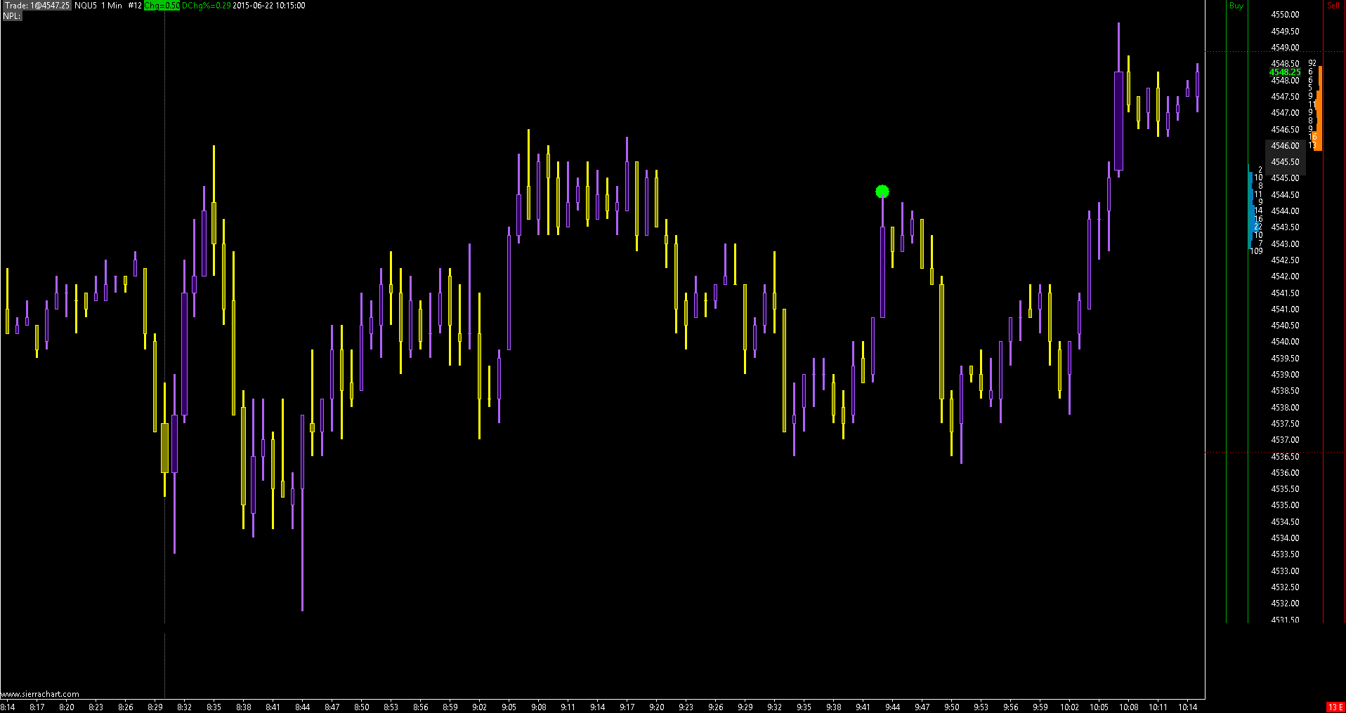

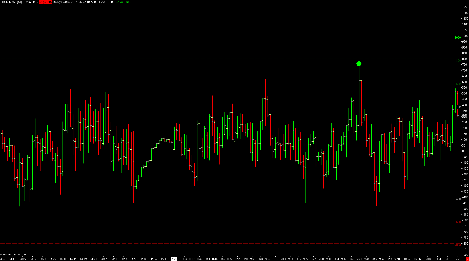

Create a chart with TICK-NYSE
Make a note of the Chart Number (Press F5, # in the title bar) e.g. #10

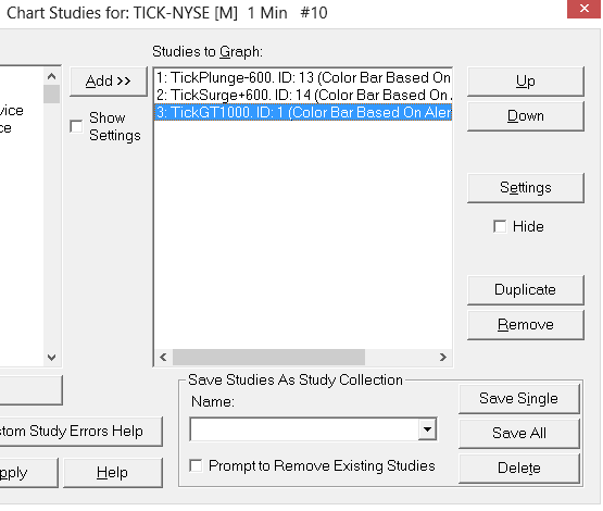

Add Study: Color Bar Based on Alert Condition
Settings and Inputs Tab: Short Name = TickGT1000 (this is just a label for you)
Subgraphs Tab: Choose a Color; Draw Style=Point on High; Width/Size=11 (so you can see it quickly)
Alerts Tab: Alert Condition= '=c>1000' (without the ' )
Make a note of the ID e.g. ID:1
On your symbol chart (ES, YM, NQ)

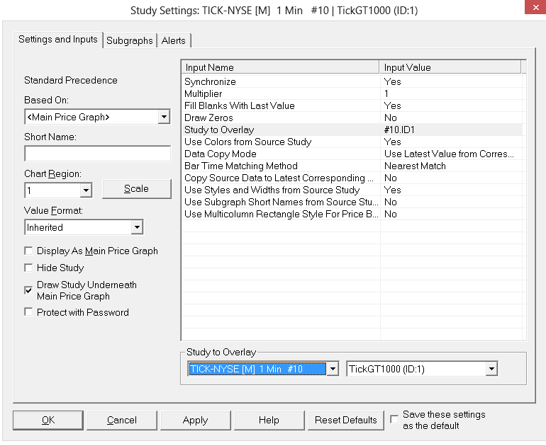

Add Study: Study/Price Overlay
Settings and Inputs: Study to Overlay; #10; TickGT1000 (ID:1)
Done.
In my images, the setting was used to print a green dot if the TICK-NYSE close was greater than 600. If you want the high of the bar instead of the close use '=h>1000'
