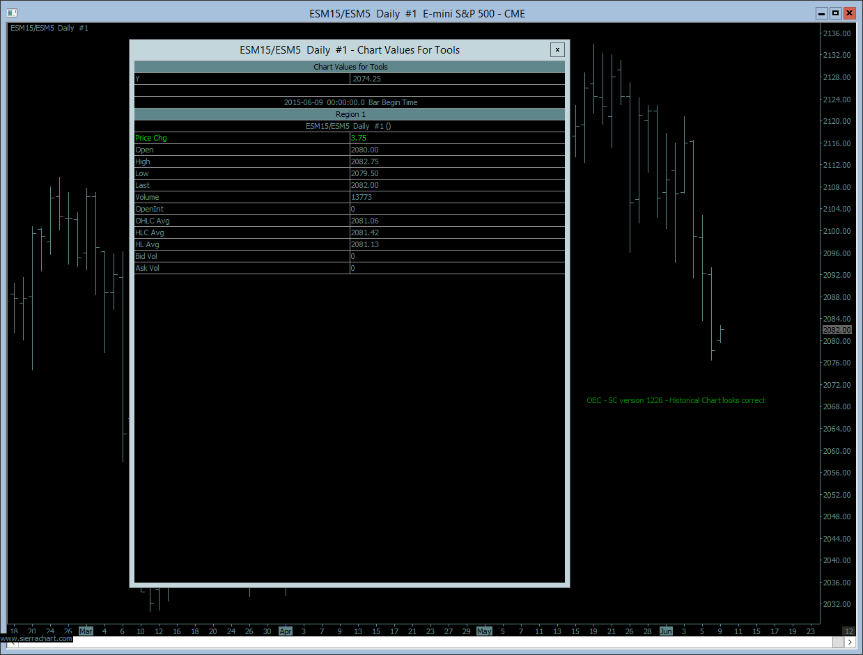

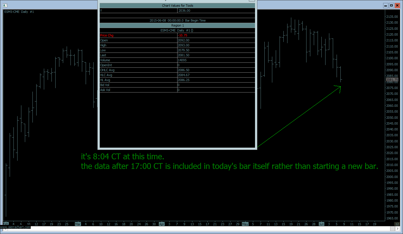

SC Team - Noticed Daily chart has not starting a new bar starting at 17:00 CT as it used to in the past. This problem started recently.
In the past - a new "daily bar" used to start at 17:00 CT but this is no longer the case since few releases back ( I am using 1261 at present)
I am referring to the ES chart.
http://www.sierrachart.com/image.php?l=1433812345396.png
Also uploaded the chartbook.
I have tested with version 1226 - OEC - Historical Chart looks correct.
http://www.sierrachart.com/image.php?l=1433814166696.png -- this is correct and this is how it used to be in the past.
Also tested with default SierraChart Historical Service - SC version 1261 and the chart is correct as well.
This indicates a problem with Rithmic data some how.
Would you please review and see what could be contributing to this issue.
