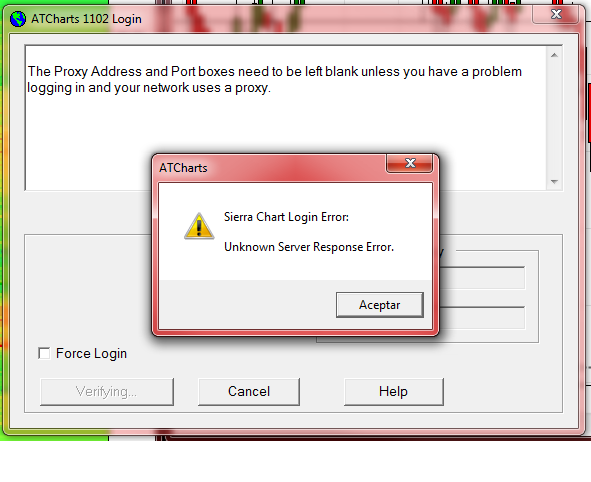

dtjacomej - Posts: 10
The problem is login in to the charting software. Here are two screen shots
imageSierra 1.png / V - Attached On 2015-06-08 17:36:47 UTC - Size: 85.09 KB - 576 views
imageSierra 2.png / V - Attached On 2015-06-08 17:36:55 UTC - Size: 69.4 KB - 458 views
[2015-06-08 17:44:16]
Clearly a proxy server is required. Follow the instructions here about this:
HTTP Communication Errors: 3 - HTTP Proxy Server
You will need to find out from your ISP, the server address and port number of the proxy.

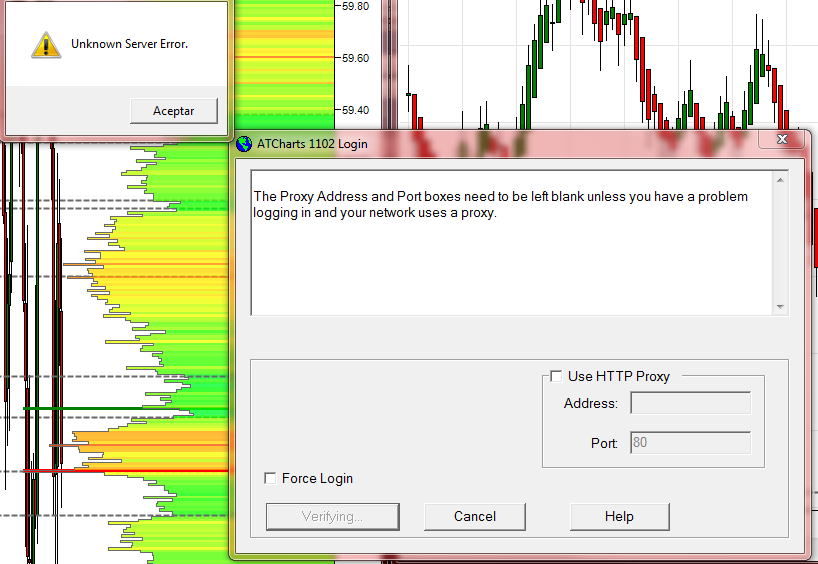

[2015-06-08 19:23:30]
I tried to login with a new trial account directly through sierra charts, not through my infinity platform, and this comes up now
imageSierra 3.png / V - Attached On 2015-06-08 19:23:24 UTC - Size: 50.63 KB - 575 views
[2015-06-08 21:14:49]
Are you familiar with how to run programs from the Windows command line?

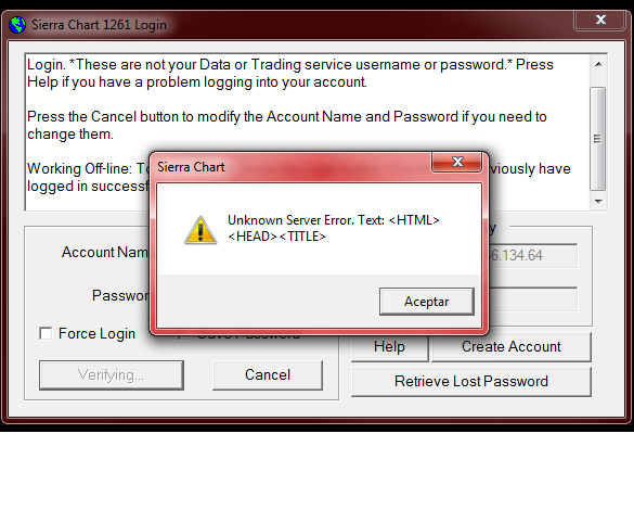

[2015-06-09 05:13:25]
We are releasing version 1262 which will show more of the server response.
Update Sierra Chart to the latest prerelease with Help >> Download Prerelease. Here are instructions:
https://www.sierrachart.com/index.php?page=doc/download.php#FastUpdate
After the update, post an image again of the response you receive after pressing the Login button.
Date Time Of Last Edit: 2015-06-09 05:13:51

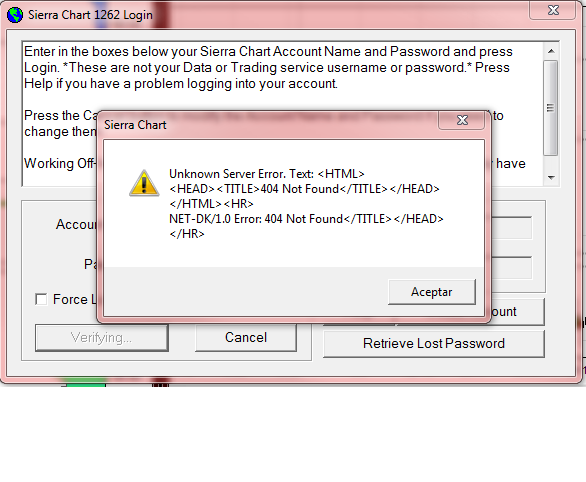

[2015-06-09 12:10:20]
I istalled the new one here is the screen
[2015-06-09 12:11:29]
here it is
imageSierra 1.png / V - Attached On 2015-06-09 12:11:26 UTC - Size: 60.58 KB - 478 views
[2015-06-09 16:21:35]
Show your ISP the HTML text after "Unknown server error. Text:". See if they recognize it.
Our only advice is to use a different ISP. This is some problem on your side with the ISP.
[2015-06-09 16:39:36]
SgtJ - Posts: 154
Might be a long shot, but go into your router a verify the dns you're getting from your isp and make sure you have the same dns #'s in windows. If you set your dns within windows to your deflt gateway that isn't 100% fool proof...use the actual dns servers #'s instead.
