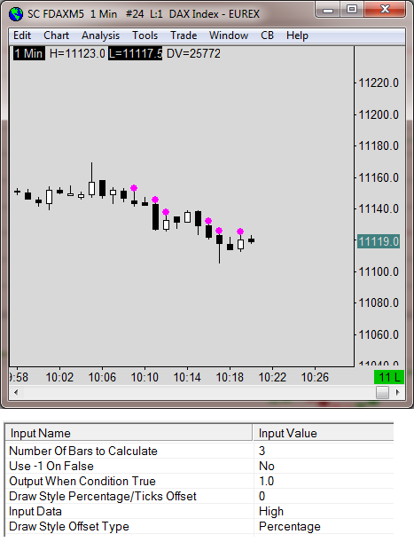

I am using the study: "Color Bar Based on Alert Condition" and I'd like to see the last 3 triggered bars only. But it do not work because there is no automatically refresh. What I have to do?
Many thanks
imageColor Bar Based on Alert Condition - Number of bars.png / V - Attached On 2015-06-08 10:34:25 UTC - Size: 33.93 KB - 626 views

[2015-06-09 23:08:45]
Sawtooth - Posts: 4361
-Put both of the attached files in your Sierra Chart \Data folder.
-Go to Analysis >> 3trigger-
-When asked 'Clear Existing Studies On Chart?', choose No.
This study will calculate all of the triggers but will only paint the 3 most recent triggered dots, counting the green and red combined.
You don't need to interact with the spreadsheet; you may minimize it.
This is for New Spreadsheets versions only.
attachment3trigger.scss - Attached On 2015-06-09 23:05:22 UTC - Size: 47.08 KB - 641 views
attachment3trigger-.StdyCollct - Attached On 2015-06-09 23:05:29 UTC - Size: 9.39 KB - 761 views

I test it but there were more than 3 dots for each. But no problem. I made a "Quick& Dirty" solution. I changed the "number of rows" to the minimum of 10.
Your Spreadsheet and Study Collection is a good base to study it. Very helpful to get in touch with spreadsheets.
[2015-06-10 04:30:37]
nicktrader - Posts: 817
@tomgilb
I "played" a little with the spreadsheet and 3trigger study and I do not know why but now it works as it should. After 3 dots the previous disapear.
