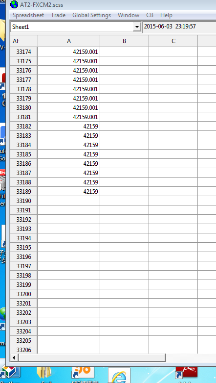

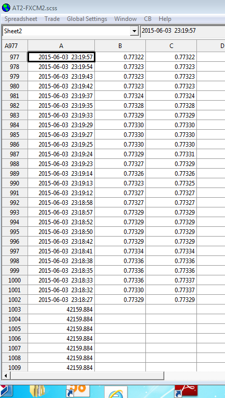

I did that (using the clear selection function, the delete row function would hang the program anyway), the file size shrinks from 16MB to 2MB, then I ran a simulation again, it fills up again the 3 sheets (sheet 1-3) that uses 1 second as time frame.
Other charts using 1 minute or longer do not have the problem.
I attached two screen shots, one from end of A column in sheet 1, the other is from 1003 of A column in sheet 2.
imageExtra Time Date Entry in Second Charts-Sheet1.PNG / V - Attached On 2015-06-06 04:16:18 UTC - Size: 62.88 KB - 536 views
imageExtra Time Date Entry in Second Charts-Sheet2.PNG / V - Attached On 2015-06-06 04:16:32 UTC - Size: 58.24 KB - 459 views
