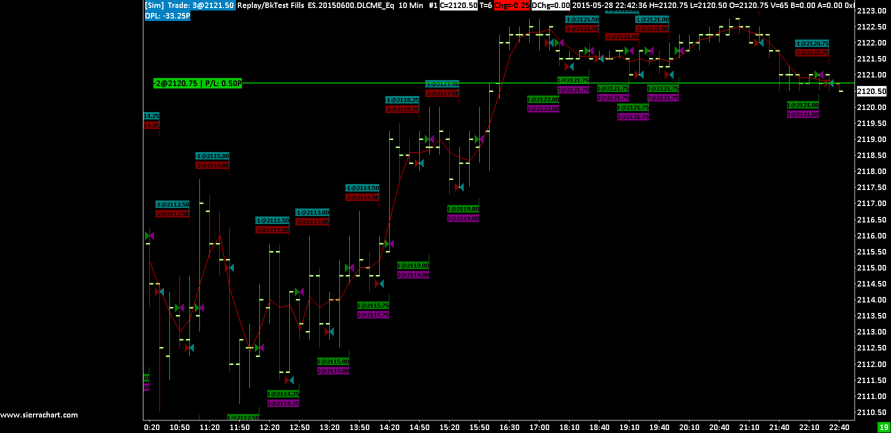

Other question: in Bar Backtest, it seems like a) the fill info and lines connecting fills on the chart do not appear. I assume this is correct but want to verify.
For me, the Bar Backtest seems plenty accurate, but it doesn't provide the sort of visual feedback and detailed trade/fill/order info in the Trade Activity Log that Accurate Replay provide.
We see these during a bar based back test. Make sure you have them enabled:
Chart Trading and the Chart DOM: Displaying Order Fills on the Chart
Here they are on a bar based back test we just did:
http://www.sierrachart.com/image.php?l=1432874802329.png
And we could see them as the back test was running.
