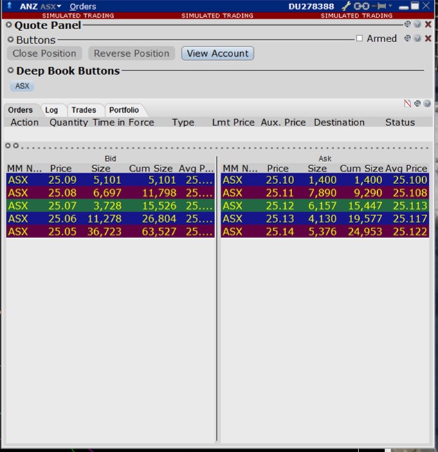

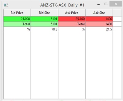

I now have an IB account and have the IB ASX (Australian stocks) live data feed working with SC but I am having the same issue with Level-2 data with only a single line of market depth (best Bid / best offer) displayed for ASX equities in SC market depth window although 4-lines of bids/offers are being displayed in the IB depth window.
Other than market depth the IB API seems to be talking to SC fine with live prices and paper trades going through fine and similarly displayed in both IB and SC displays..

I have attached the market depth windows I am seeing and my log file albeit in after hours mode without the live feed working; let me know if you require a log of when the IB data feed is working.

The ASX level 2 that IB provides is incomplete. It's only 5 levels of depth, where is the rest?
SC are better off natively supporting the ASX and forgetting about IB.
The issue with the IB API and market depth probably has something to do with IB's SMART routing.

Prior to SC release 1358 there was only best bid-offer for ASX stocks displayed in SC DOM although SC1358 resolved this for stocks. I still only get best bid/offer for tradable IB CFD symbols which is what I trade. The DOM issue is with IB I.e. as you say, due to the SMART routing which I don't believe can be turned off (?), there are order routing options in IB TWS settings but all variations on SMART routing.
After some trial an error this is what I found with the following ASX Symbols;
CODE-CFD-ASX-AUD - 5-DOM levels - TWS does NOT accept trades from this symbol
CODE-CFD-ASX - 5-DOM levels - TWS does NOT accept trades from this symbol
CODE-CFD-SMART-AUD - NO DOM - only best Bid/Offer - TWS accepts trades from this symbol
CODE-CFD-SMART - NO DOM - only best Bid/Offer - TWS accepts trades from this symbol
CODE-STK-ASX - 5-DOM levels - TWS accepts trades from this symbol
My last response from SC was that a new SC feature in a yet to be released SC version will address this issue;
"Chart >> Chart Settings >> Trade and Current Quote Symbol" to function as a Trade Only symbol which will solve this problem.
