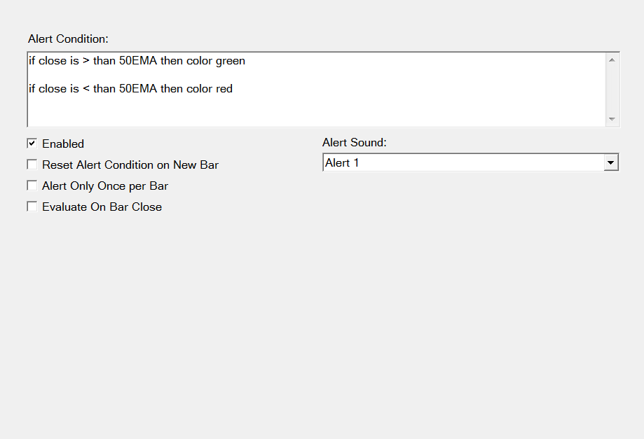

[2015-05-28 16:15:34]
User28682 - Posts: 233
I dont understand what this means:
"Use an alert formula of 1, and that will color all of the bars which will validate the study is working properly"
Attached is what I did, but so far nothing happens.
Tom
imageEMA_cross.png / V - Attached On 2015-05-28 16:14:54 UTC - Size: 15.75 KB - 605 views
[2015-05-28 17:43:22]
You need to understand how to write the alert formulas.
Here is the documentation for this:
https://www.sierrachart.com/index.php?page=doc/doc_AlertCondAndScan.html
Those formulas you have written, are not valid at all to Sierra Chart.

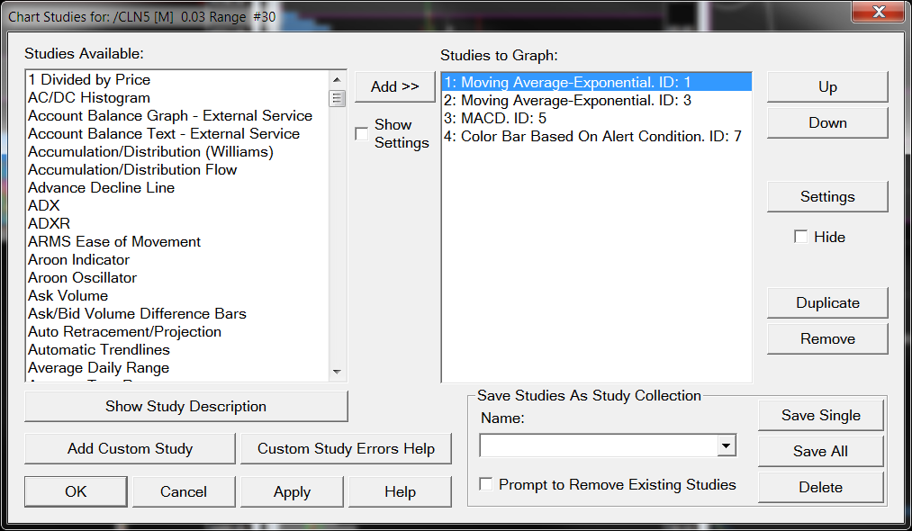

[2015-06-02 03:15:38]
Previous facts:
MACD : ID5
Moving Average Exponential : ID1
Moving Average Exponential : ID3
Alert field:
=AND((ID.5crossover(SG1,SG2),SG1 < 0),C < ID.1.SG1, C > ID3.SG1)
I want a price bar color coded if:
close is < 50 EMA and close > 100 EMA AND MACD SG1 crosses below SG2 AND SG1 is > 0
I am more interested in the price bars changing color on the condition being met than the alert.
If I want this "buy" condition met with a pink bar, based on these facts, do I need 1 "Color Bar Based On Alert Condition" to show "buy" examples as this code wants? If so where does it go in the list of Studies to graph? Attached is what I have now, using only one.I cant get it to show ANY colored bars, where is the setting to tell it to do it and what color to do it?
Thanks for your help.
Tom
imageColor_Bar_Based_on_Alert.png / V - Attached On 2015-06-02 03:14:29 UTC - Size: 88.86 KB - 590 views
[2015-06-02 15:29:37]
Thanks for all, I got it to work. How does one change the color for a bar?
