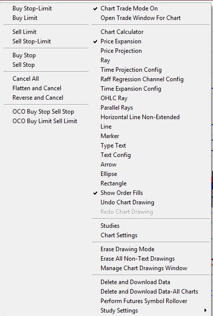

P.S. I am attaching a screen shot of my shortcut menu as it currently is, in case this helps duplicate the issue.
Date Time Of Last Edit: 2017-04-26 15:33:26
imageShortCutMenu.JPG / V - Attached On 2017-04-26 15:31:01 UTC - Size: 122.8 KB - 371 views

Ok, here's the sequence of events:
- Click on Menu "Global Settings"
- Select "Customize Chart Shortcut Menu" (Window opens)
- Highlight "Time Expansion" tool from "Available Menu Items"
- Click on "Ray" in "Selected Menu Items" (because I want the tool to appear after "Ray")
- Click the "Add" button ("Time Expansion" appears after "Ray" in "Selected Menu Items")
- Click "Ok" to close dialog box
- Right click on chart screen to display Shortcut Menu
- The expected "Time Expansion" tool appears as "Time Expansion Config" (NOT WHAT I WANT!)
(Rinse and Repeat)
- Highlight "Raff Regression Channel" tool from "Available Menu Items"
- Click the "Add" button ("Raff Regression Channel" appears after "Ray" in "Selected Menu Items")
- The expected "Raff Regression Channel" tool appears as "Raff Regression Channel Config" (NOT WHAT I WANT!)
(Rinse and Repeat)
- Highlight "Time Projection" tool from "Available Menu Items"
- Click the "Add" button ("Time Projection" appears after "Ray" in "Selected Menu Items")
- The expected "Time Projection" tool appears as "Time Projection Config" (NOT WHAT I WANT!)
Each time I open up the window to add to or see the "Selected Menu Items", the corresponding "Config" tool is there, not the tool I originally selected.

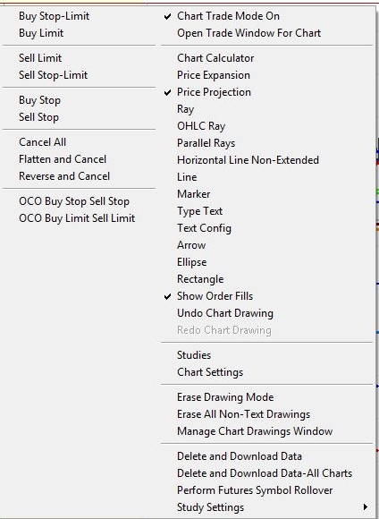

Attached is another screenshot showing the results. Hope this helps!
Date Time Of Last Edit: 2017-04-26 19:00:54
imageShortcutMenu2.jpg / V - Attached On 2017-04-26 19:00:44 UTC - Size: 142.82 KB - 351 views
[2017-04-26 18:45:07]
After this step:
- Right Click on chart screen to display Shortcut Menu
What is the particular problem?
[2017-04-26 19:09:52]
User58241 - Posts: 24
Seems part of my explanation accidentally posted before I had completely described the problem, so you may not have read the whole thing. Sorry about that!The problem is that the "Config" option of whatever tool I choose comes up in the shortcut menu, not the tool I actually want. This is really strange, but it is what it is. Just hope you can duplicate it. Thanks again!

[2017-04-28 05:14:42]
Disregard the prior post, we know what the problem is now.
You are actually adding the wrong commands but it is easy to get confused about that because they do not have "Config" at the end of them.
In the long list of commands when you customize the chart shortcut menu, you need to add the first tool command you see in the list.
[2017-04-28 11:19:38]
I wasn't sure what you meant at first with your explanation above. However, I just spent a fair amount of time going through the whole list of shortcut menu possibilities. Interestingly, it never occurred to me that some of the items listed were actually SUBHEADINGS for the items that follow, and I didn't realize that there would then be multiple listings of the various tools that I seemed to be having trouble with. THANK YOU for clearing this up for me!! I apologize for not being more observant as I went through the list before. Like I mentioned previously, I don't spend a whole lot of time dealing with adding or subtracting tools from the shortcut menu--when I want an item, I go to where I need to go, look for the name of the tool, and then add it! Had there been some indentation of the tool names from the subheadings, I might have noticed this earlier. MY MISTAKE!
Again, thank you! Sorry for putting you through this. YOU "GUYS" ARE THE BEST!
Dan
[2017-04-28 17:58:30]
The problem is solved in the latest prerelease because we added "Config" to the end of the commands that actually are for the Drawing Tool configuration window.
Update to the latest prerelease following these instructions:
http://www.sierrachart.com/index.php?page=doc/SoftwareDownload.php#FastUpdate
