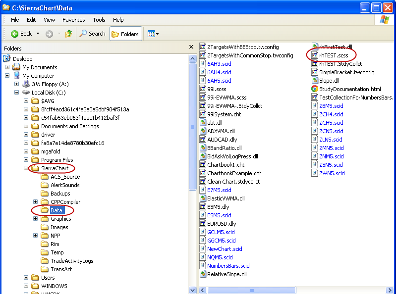

Finally, from the main menu I selected File >> Open Spreadsheet. No files showed up on the list at all, not the spreadsheet I just created or either of the other spreadsheets previously created. However, the .scss files are in the \Data folder and I can access the spreadsheets via the spreadsheet trading study.

This does not make sense. When you select File >> Open Spreadsheet, at the top of that window you will see the path to the folder it is displaying. Is it the correct path?
[2015-05-20 13:02:13]
User911705 - Posts: 89
Path is default and correct. I've attached screen shots of the Open Spreadsheet dialog window and a shot of my Data folder.
If this is incorrect behavior, I'm guessing the problem is not the other computer but that mine is not properly exporting the .scss file.

[2015-05-20 16:58:37]
We want to focus on the first problem of the files not displaying. Select File >> Open Intraday Chart. Do you see any files listed?
Update Sierra Chart to the latest release with Help >> Download Current Version. Let us know if you still see the problem.

There are files shown on the Open Intraday Chart dialog window, but not on the Open Spreadsheet.

[2015-05-20 17:46:58]
We have extended your trial. Restart Sierra Chart.
There is a problem with the file filter in the version you are running. Update to the latest prerelease with Help >> Download Prerelease.

[2015-05-20 21:50:36]
I think this may have resolved the issue. I can now see and open spreadsheets for the File >> Open Spreadsheet dialog window. The text in the ss's and the various message log windows is also now of a more desirable formatting (smaller text, not as bold). Seems like it should be now.
