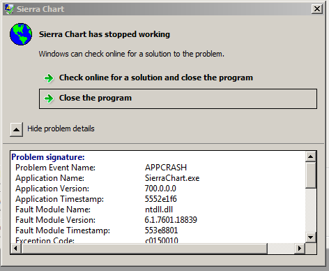

I followed your instructions to delete the SierraChartStudies.dll file and reinstalled it in the same folder. It still crashes when clicking on Add Custom Study. The fault name is a ntdll.dll file. See attached.
I then installed it in a new different folder, and it doesn't crash.
Something must be corrupted in the original install that a reinstall doesn't overwrite. Please advise.
