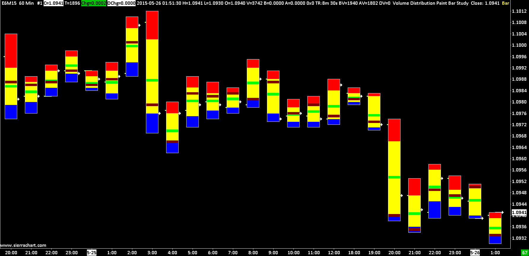

Hi, I'm looking at this study. I loaded a 15m 6E Chart with the default settings but can't see why the bottom 15% volumes are not printing - See enclosed.
Any ideas?

We had a quick look at the study and the calculations appear to be correct. For the 6E, we do see the bottom 15% (the default) volume being colored:
http://www.sierrachart.com/image.php?l=1432620156386.png
Go to the Subgraphs tab of the Study Settings window for the study and check the color settings.
[2015-05-26 06:12:42]
From the chart image in the first post we can see the color settings are correct.
However, we see that you are not running the current version of Sierra Chart. There were some recent changes to the study. Update Sierra Chart to the latest release.
Also make sure you have a tick by tick data configuration:
http://www.sierrachart.com/index.php?page=doc/doc_TickbyTickDataConfiguration.php

Al SC Developer - Posts: 434
Check your input for the Low Volume Percentage. If it is negative or greater than 100 then you will see the behavior that you are observing. Also if it is expressed as a small value < 1 (i.e. .01) you will likely only see low volume plotted on a few bars. The intent of the study is to specify a percentage like 15% not with values of .15.
We will be changing this to enforce valid ranges and better interpret decimal values. Also, the doc is still being worked on.

User78442 - Posts: 260
I've updated SC and the study looks to be functioning fine. Thanks for your input!
