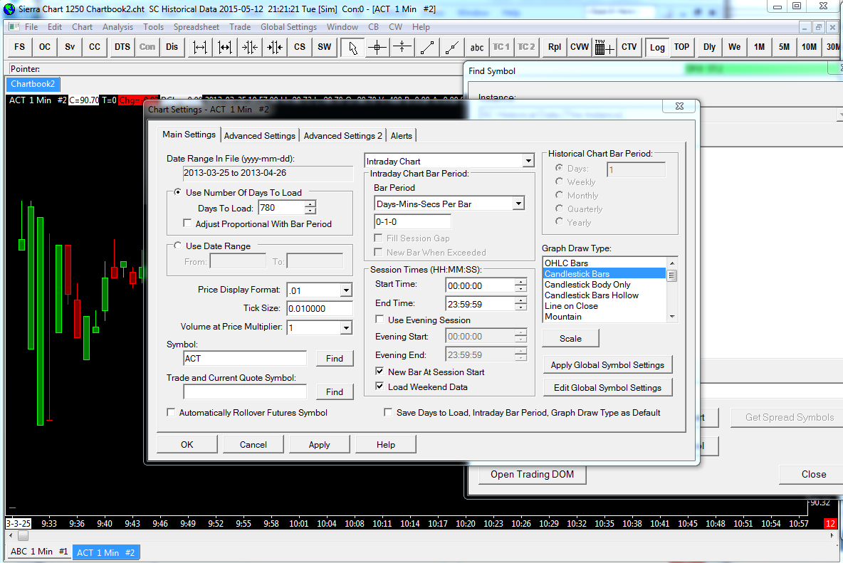

I'm trying to display 2 years of intraday data on chart and download using the Write Bar To File study.
It displays and downloads data only from 3/25/2013 to 4/16/2013, even though i specified "Number of Days to Download = 780" in the Chart Settings.
Attached is data from ACT-BarData.txt file and a screenshot showing Chart Setting.
How do i get it to display and download the entire 2 years from 5/1/2013 - 5/1/2015?
thanks
Kiran
imageChartSetting.PNG / V - Attached On 2015-05-12 21:27:52 UTC - Size: 150.73 KB - 529 views

I tried the process described - changed the Chart Setting and Global Setting to 780 days and deleted and re-downloaded the data for ACT. I still have the issue
My trial is still active for another day, so not sure what changed - it is only downloading from 3/25/14-4/16/14 and as i showed in the attached ChartSetting.png, the field is greyed out, so i can't change the dates.
