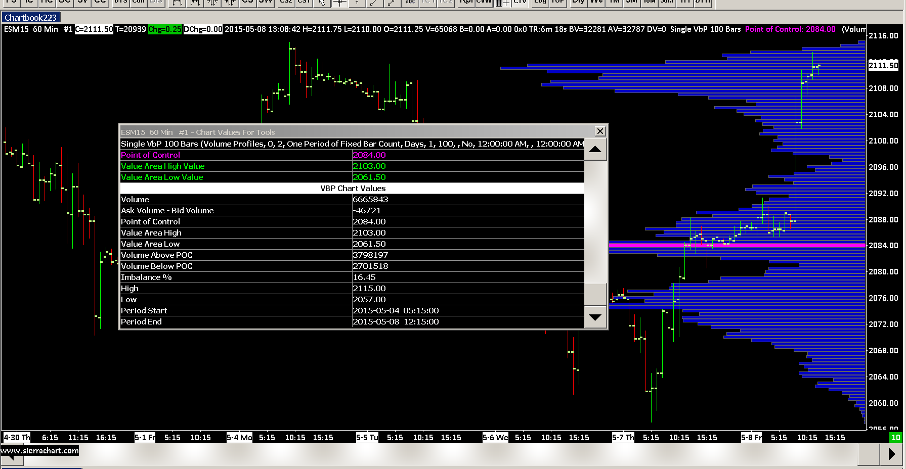

You can do what you want. Here is a screenshot of the chart and of the Tool Values window which shows the relevant Input settings of the Volume by Price study configured the way you need:
http://www.sierrachart.com/image.php?l=1431205390298.png
You can programmatically access the point of control using the point of control Subgraph, sc.Subgraph[1], from the Volume by Price study.

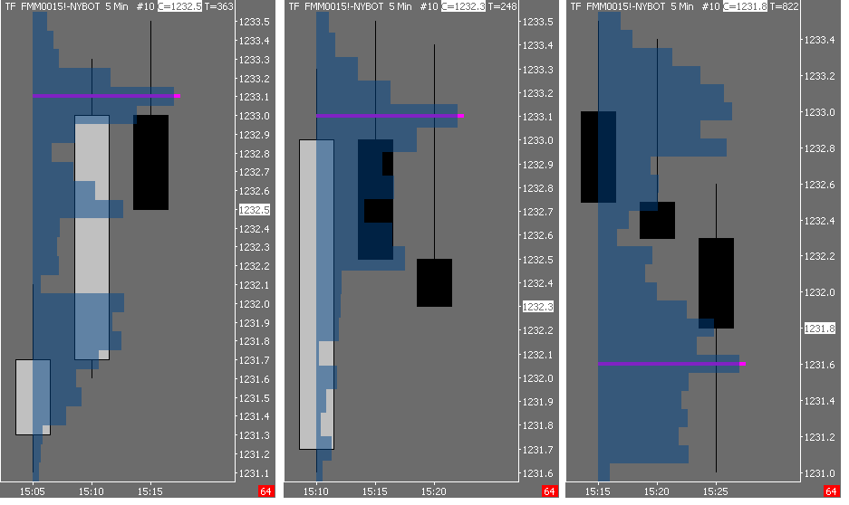

Re sliding window, it seems the only way to do it is as mentioned above re using the visible bars option in "volume graph period type".
Set your chart window to the number of current bars you want to see...in this case I chose 3.

Thank you so much for replying quickly and on a weekend no less. What you've shown in post #5 appears to be just what I need.
Since I'm just learning and trying to remember everything, can you please verify the following: I assume that using such a rolling vpoc (as I call it) calculation in a trading system would require using the replay method to do the backtest. Since this indicator only plots the most recent profile, I assume that's the only value that would show up in a bar by bar backtest. Please correct me if I have this wrong.
[2015-05-10 04:16:06]
Yes this is correct:
We verified this now by using Trade >> Auto Trade System Bar Base Back Test.
And setting the bar processing increment to 10. You can do the same thing and observe this.
