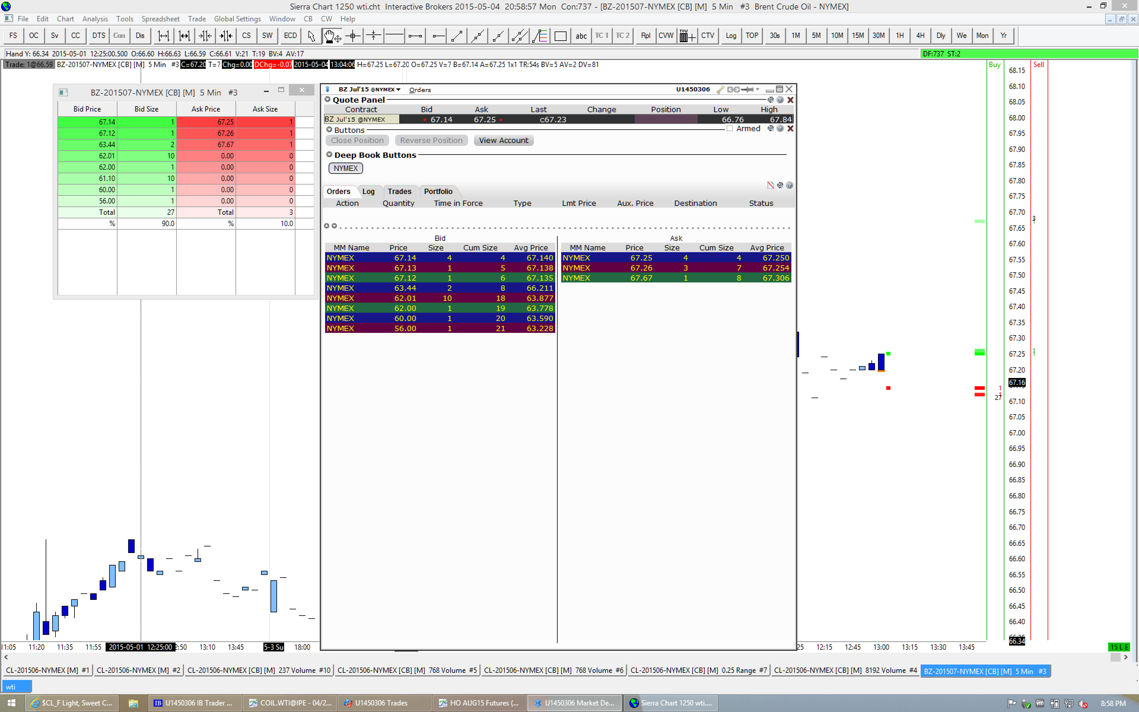

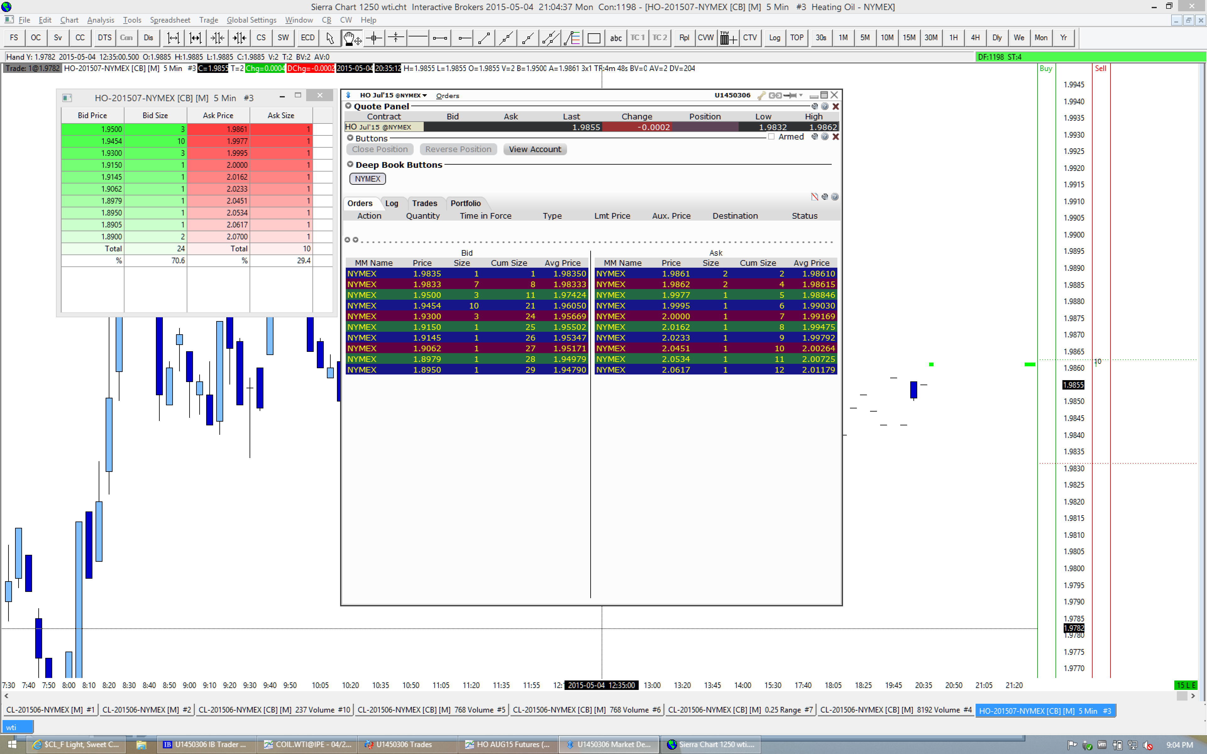

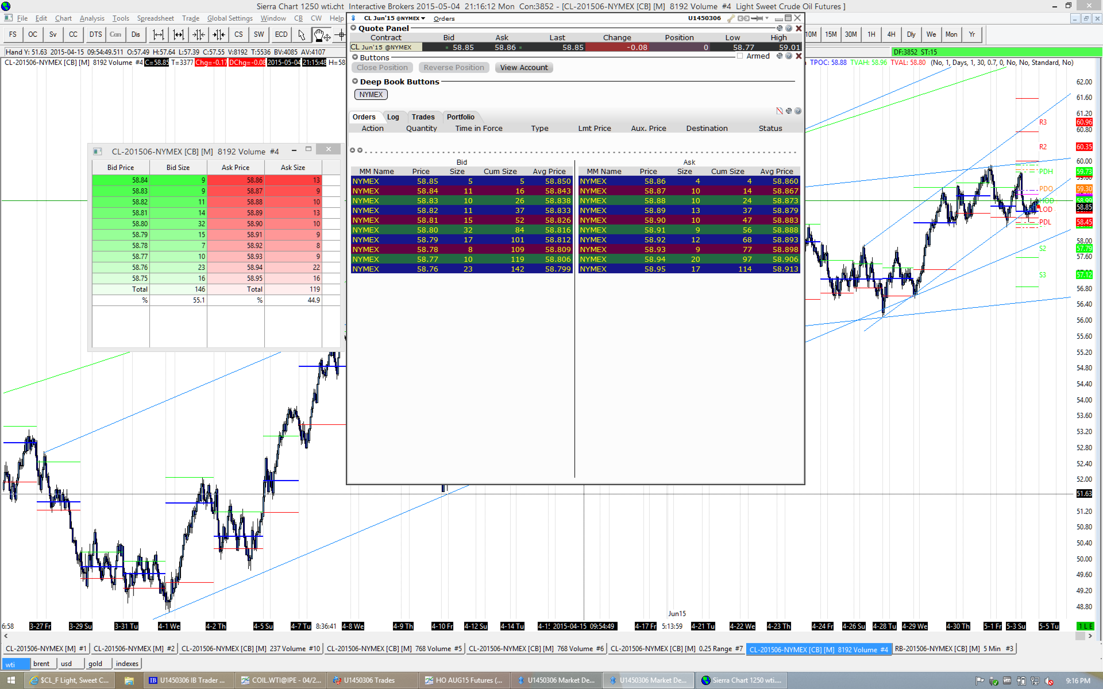

i960 - Posts: 360
Still seeing market depth weirdness with BZ, HO, RB. Something has changed here.
The depths I'm seeing with various NYMEX related instruments are not the same as what I'm seeing in the IB DOM (which is not known for being inaccurate) and the data is coming from the same place. The market also does not have enough volume right now to have something like market data delays be an issue so the fact that the depths will stay different for multiple seconds at a time indicates a problem to me. In the past SC and IB were always in sync without issue. Now, I see differences with CL, BZ, HO, RB, but don't see any differences with GC (which never had any issues today).
And I've restarted SC before taking screen captures, no change.
Date Time Of Last Edit: 2015-05-05 04:21:14
imagesc_data_ho_20150504.png / V - Attached On 2015-05-05 04:17:06 UTC - Size: 434.43 KB - 422 views
imagesc_data_bz_20150504.png / V - Attached On 2015-05-05 04:17:15 UTC - Size: 440.66 KB - 495 views
imagesc_data_cl_20150504.png / V - Attached On 2015-05-05 04:17:23 UTC - Size: 589.73 KB - 494 views
imagesc_data_gc_20150504.png / V - Attached On 2015-05-05 04:17:32 UTC - Size: 434.24 KB - 461 views

We had a look at this. The market depth data you see is direct from the CME multicast data feed. We have 2 of these connections and both show identical data. There is no evidence of a problem.
