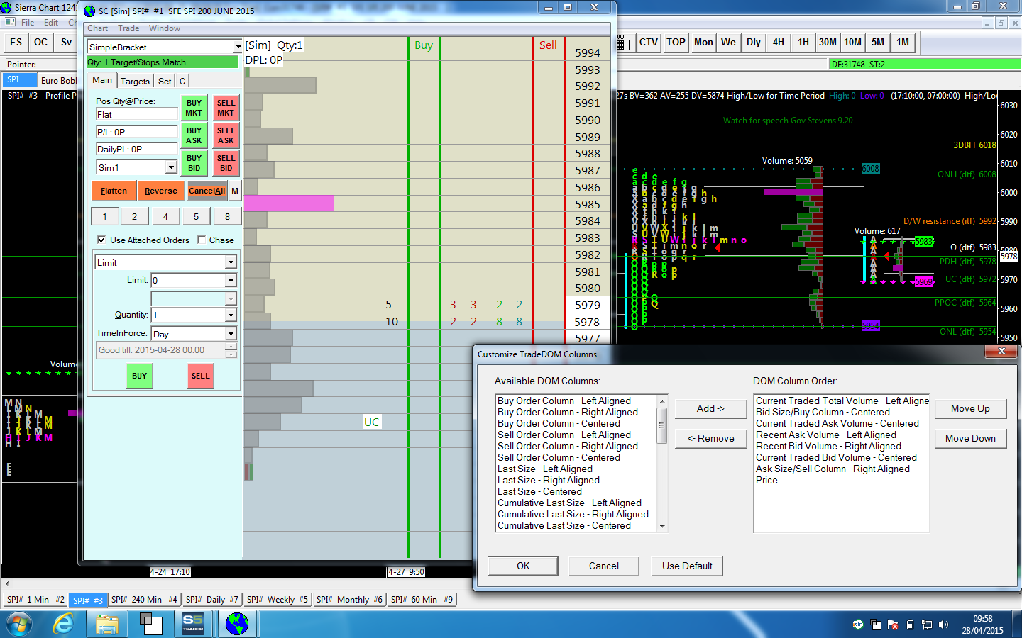

There may be something I'm doing wrong here. However sometimes bids/offers shows up other times they dont.
Pleased to hear if you can help.

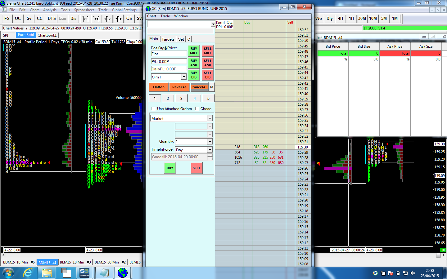

Select Chart >> Open Market Depth Window on the menu. Do you see the market depth displayed there?
[2015-04-28 10:39:01]
olambeth - Posts: 30
No
[2015-04-28 10:39:49]
Please see attached.
imageScreenshot 2015-04-28 20.38.24.png / V - Attached On 2015-04-28 10:39:39 UTC - Size: 295.09 KB - 514 views
[2015-04-28 10:40:24]
Please contact IQ Feed about this.

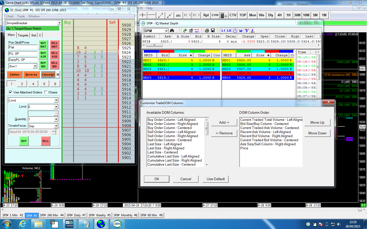

I have contacted IQ Feed. From looking at the raw data via the Market Depth I can see the data comes through ok.
I have my column settings up too. Please can you kindly provide a solution here.
Oliver
imageScreenshot 2015-04-28 22.19.01.png / V - Attached On 2015-04-28 12:21:31 UTC - Size: 342.23 KB - 531 views
[2015-04-28 17:45:00]
We still suspect the problem is on the IQ Feed side. We want you to restart the IQ Feed software explained at step 10 here:
DTN IQ Feed Data Service: Setup Instructions
We will also do some testing.
If you still have a problem provide a copy of the Message Log.
Provide a copy of the Message Log, by following these instructions:
http://www.sierrachart.com/index.php?l=PostingInformation.php#log
