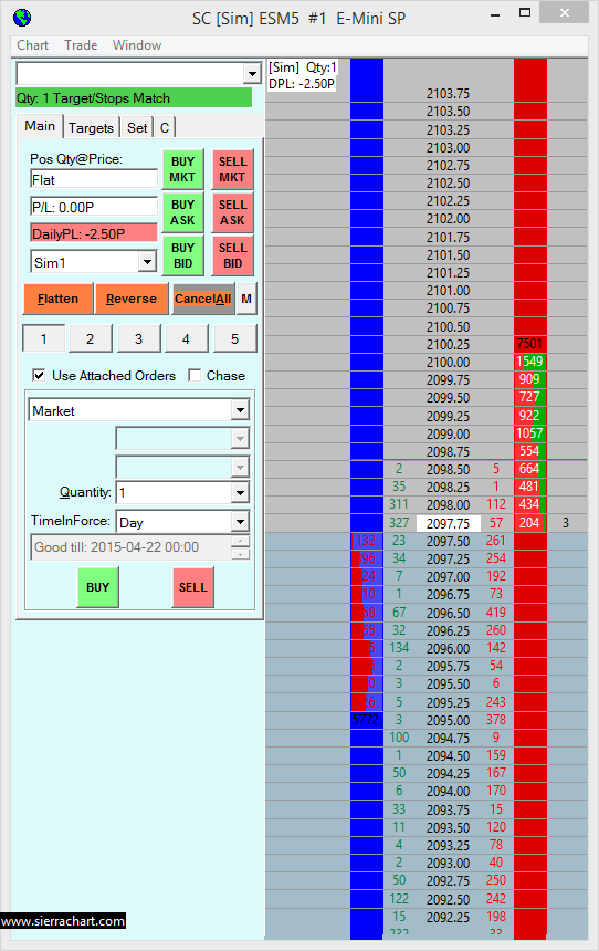

Hi there, I was hoping someone could help me with a bit of the DOM configuration.
Here is my current setup:
http://prntscr.com/6wu8ke
I was hoping someone could help me figure out how to change the color of the prices in the bid colomun to white like they are in the ask column.
Also, is there a way to change the histogram to switch sides so the bars are on the inside facing outward?
Finally, can someone tell me where I can configure how the most recent market prices (the numbers closest to the price) refresh?
Appreciate any help!

http://www.sierrachart.com/image.php?l=1429723425417.png
e/ the column is the recent bid volume - centered

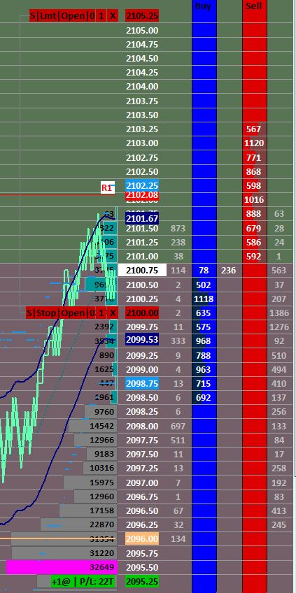

WarEagle - Posts: 80
Strange, I just changed my ask column text from white to black as a test and it worked just fine using this method. See attached pics.
imagedom.jpg / V - Attached On 2015-04-22 18:02:40 UTC - Size: 84.43 KB - 585 views
imagedom2.jpg / V - Attached On 2015-04-22 18:04:25 UTC - Size: 83.55 KB - 582 views
