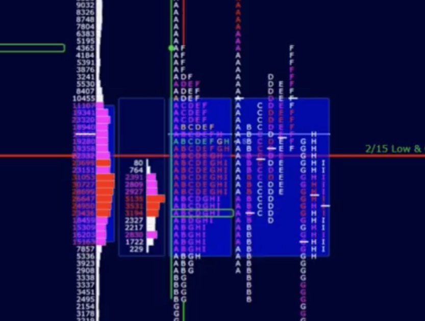

I would also like to see this capability. Everyone who follows Jim Dalton would appreciate seeing this indicator on the TPO chart.
attachment90F5C2AB-AC41-4602-89B3-DBDE9C05A6A4.jpeg - Attached On 2022-02-17 20:01:25 UTC - Size: 249.67 KB - 560 views

I wonder if there is any way to show the sub period midpoint on the Label column of the Chart DOM. For example, it could show as A MP for A period, B MP for B period but over in the label. My thinking here is that would be a useful reference for someone that pays close attention to those areas on a TPO chart when they are looking at a different chart like candlestick, etc.
If this isn't possible, might it be possible to add to the TPO Value Area Lines study under Subgraphs?
I can put the daily midpoint on the Label column using Daily OHLC which is very useful, but it would be great to have each period's midpoint (halfback in Jim Dalton terms) on the Label column.
