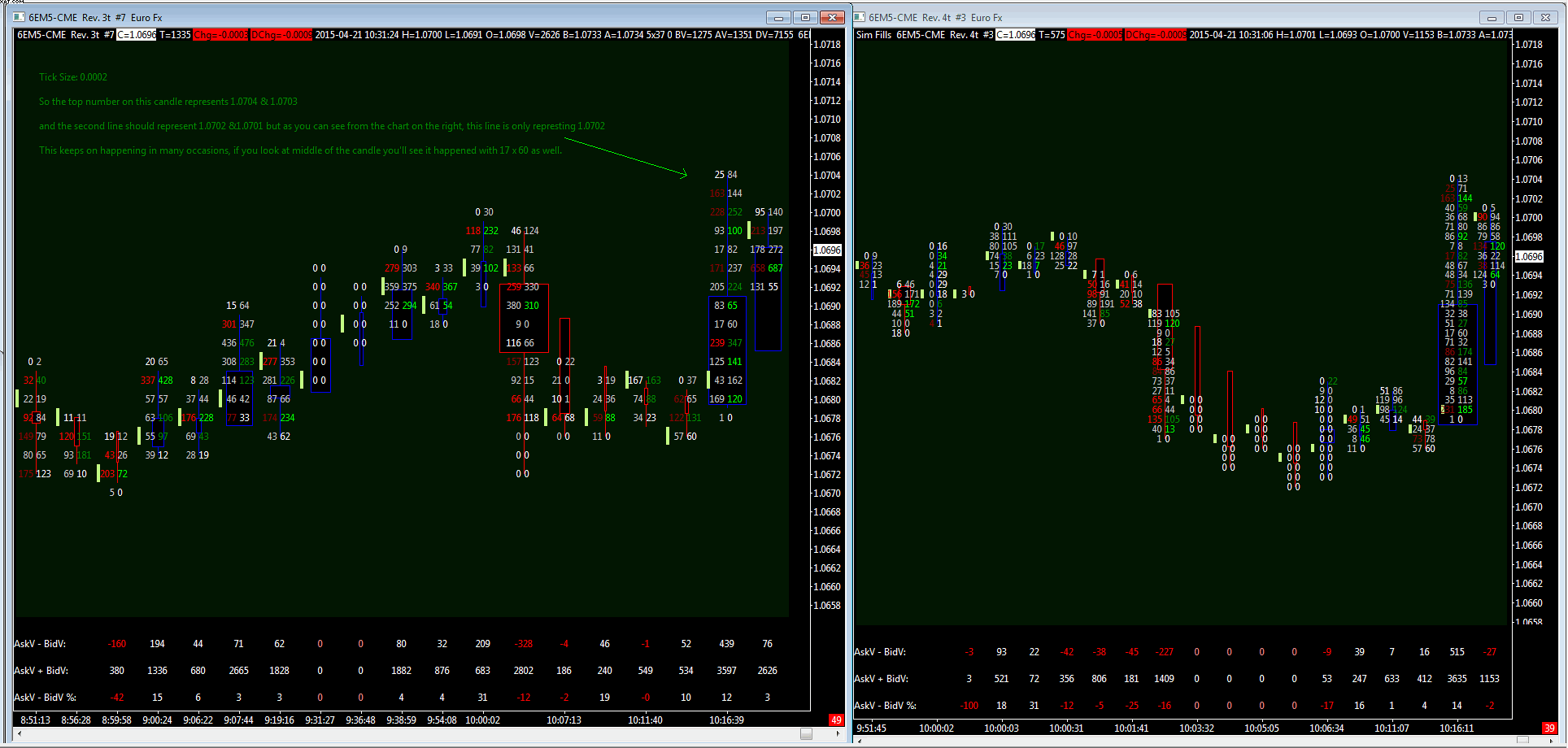

I've come across a problem with Numbers Bars.
As you can see in the attached screenshot, I have two charts.
Chart 1, tick size: 0.0002
Chart 2, tick size: 0.0001
in Chart 1; Numbers Bars are sometimes printing 0.0001 tick and 0.0003 tick totals instead of 0.0002. Is this a known issue?
imagetick size 0.0002 vs 0.0001.gif / V - Attached On 2015-04-22 01:53:05 UTC - Size: 105.52 KB - 682 views

[2015-04-24 02:43:16]
We are not willing to spend more time on this. It is nonstandard to be using a different tick size which differs from the underlying data. And we can go through the time to debug this but we do not think we would find anything wrong and the outcome is likely to be mathematically correct.
Doing what you are is affecting the normal behavior of these calculations.

[2015-04-25 06:35:42]
It is not a bug. We have given this more thought and we understand exactly why it occurs. It has to do with floating-point error and it is difficult to deal with in this particular case. For example the number 1.5001 might actually internally be 1.5000999999 and this affects the value it is rounded to.
We will continue to think about how to resolve it, because if we try to solve it we could introduce other side effects and this is something we are extremely hesitant to do.

[2015-05-16 23:41:59]
Update to the latest prerelease and let us know if you still see the problem. Select Help >> Download Prerelease. We have made a change now which should resolve this. Please let us know.
Date Time Of Last Edit: 2015-05-16 23:42:16
[2015-05-18 10:22:23]
User727623 - Posts: 17
looks ok now, many thanks!
