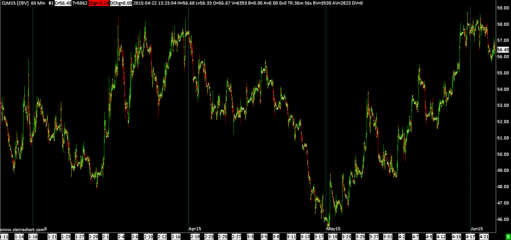

When I did a rollover from K5 to M5 contract for the CL, I have a gap in the chart from 04/02/15 to 04/16/15, inclusive. I had this same thing happen the last rollover. What box do I need to check or uncheck to correct this? I have the same gap no matter what time frame chart I look at that is intraday.
I think I just figured out the answer. I changed the rollover rule to date based instead of volume based and it worked.
Thanks.

The basic problem with most everything being said in the thread is that we cannot duplicate the problem and it does not make sense that this problem would exist when the data is re-downloaded because these kinds of issues are due to missing data and once the data is re-downloaded, there should no longer be missing data so the problem should no longer exist.
Here is a continuous contract chart using back adjustments and using volume rollover for CL:
http://www.sierrachart.com/image.php?l=142972518153.png
Once again, follow through the instructions here:
https://www.sierrachart.com/index.php?page=doc/doc_ContinuousFuturesContractCharts.html#ReDownloading
It should not matter, but update to the latest prerelease as well.
If there still is a problem, let us know and we will will give you instructions on what to do to give us to Message Log. But please do not post the message log until you follow our specific instructions so we are not overwhelmed with information.
Also, when highlighting the rollover points as suggested in the instructions (Chart >> Show Rollover Dates), there are a few months (in a 12 mo period) not being displayed with a vertical line in the [CBV] chart. All lines are displayed in the [CB] chart.
This has been corrected in the latest prerelease.
And of course you will have differences in the charts when you switch between date based rollover and volume-based rollover. That is to be expected. There is nothing unusual there. And for a commodity contract like CL, you will need to use the volume-based rollover for accuracy.
Date Time Of Last Edit: 2015-04-22 18:00:14
