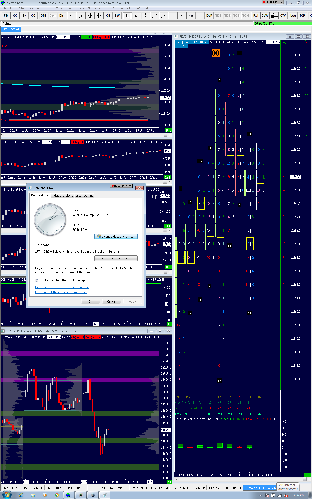

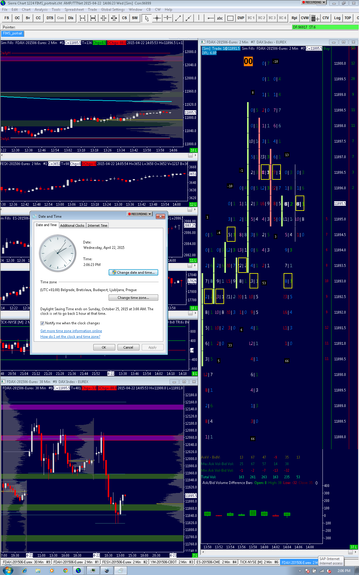

[2015-04-22 12:25:12]
User742670 - Posts: 43
As you can see on the screen shots I attached in sequence (1),(2),(3),(4)...
The PC clock is already past the time where new candle should starts as the time ran out...
But is still drawing old candle as you can see on the volume going up and the countdown timer
is still on 00...
Then after approximately 27 seconds countdown timer changes the value from 00 to 1:23 and then new
candle starts drawing...
This is really strange and I cannot trade with such conditions..many thanks for looking into it
regards
David
imageCandle 2 min (1).png / V - Attached On 2015-04-22 12:17:51 UTC - Size: 134.31 KB - 501 views
imageCandle 2 min (2).png / V - Attached On 2015-04-22 12:18:00 UTC - Size: 133.78 KB - 604 views
imageCandle 2 min (3).png / V - Attached On 2015-04-22 12:18:06 UTC - Size: 134.3 KB - 509 views
imageCandle 2 min (4).png / V - Attached On 2015-04-22 12:18:18 UTC - Size: 132.3 KB - 584 views
