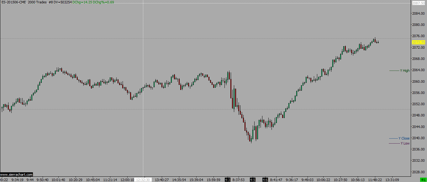

The 2000 Trades chart for today correctly shows the previous days H/L/C as being Friday 3 April (the short day).

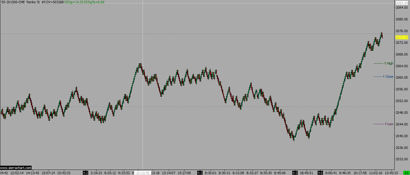

However the 3T Renko chart shows the previous day H/L/C as being from Thursday 2 April.

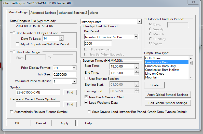

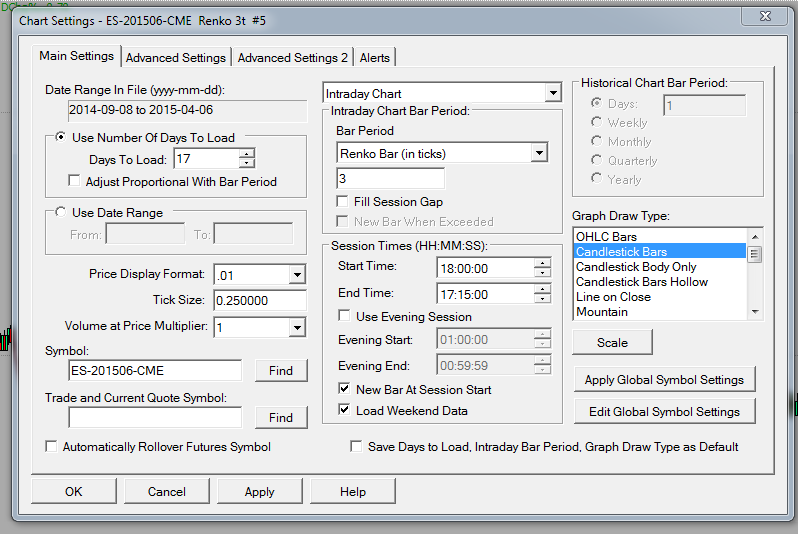

Both charts have the same chart settings (apart from bar type) - see attached.

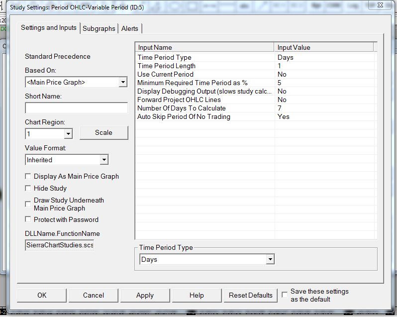

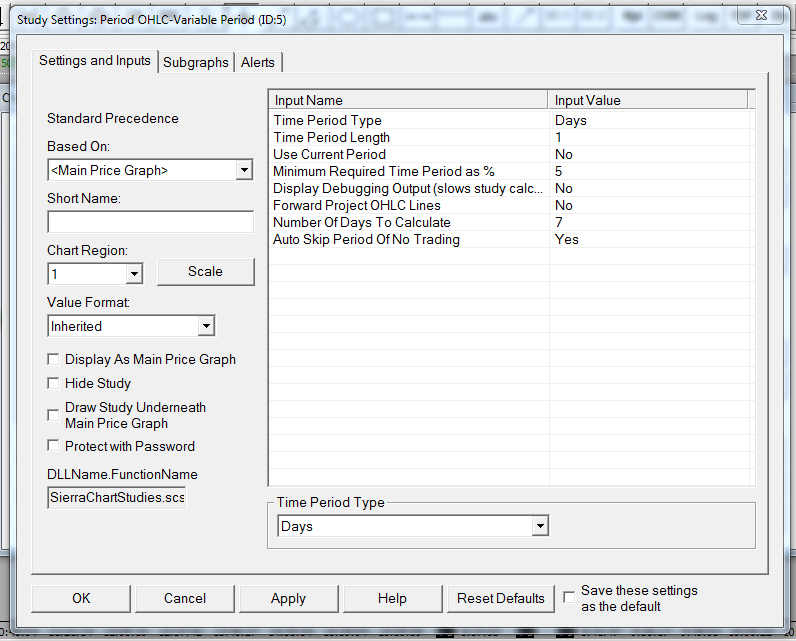

Both instances of the study have the same configuration - see attached.

imageES-201506-CME 2000 Trades #8 2015-04-06 11_58_53.251.png / V - Attached On 2015-04-06 17:42:14 UTC - Size: 29.46 KB - 506 views
imageES-201506-CME Renko 3t #5 2015-04-06 11_59_12.069.png / V - Attached On 2015-04-06 17:42:23 UTC - Size: 37.52 KB - 530 views
imageRenko chart settings.PNG / V - Attached On 2015-04-06 17:42:49 UTC - Size: 54.65 KB - 464 views

imageTrades Chart Settings.PNG / V - Attached On 2015-04-06 17:43:13 UTC - Size: 54.12 KB - 481 views
imageTrades Study Settings.PNG / V - Attached On 2015-04-06 17:43:24 UTC - Size: 91.3 KB - 508 views

This question is not within the scope of our support. It is very complex to analyze.
There is definitely no bug.
Possibly changing the Minimum Required Time Period as % setting might make a difference. But there could be something else going on with the data and the chart settings.
Date Time Of Last Edit: 2015-04-07 09:46:44
[2015-04-07 09:54:49]
The study has a setting "Display Debugging Output". You could set that to Yes an examine the Window >> Show/Hide Message Log for a better understanding of how it is referencing the data and skipping periods.
