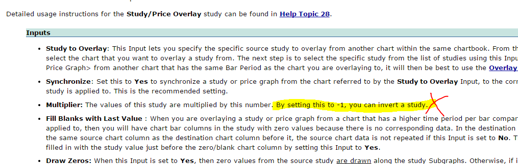

I have noticed what I believe to be a mathematical error with how you describe the Multiplier parameter can be used in the Study/Price Overlay (and I assume by extension the Overlay - Line study) - see attached screen grab. You say that by using -1 (negative one) you can invert a price study. I think this is incorrect. To truly invert you need to divide by 1. Is it possible to fix this so it is a divisor and not a multiplier? Eg the Yen futures contract with the USD is quoted the inverse to what most media/data sources show it as. Right now the futures are about 0.8416 whereas most will quote it as 118.82. Now dividing .8416 by 1 only gets you 1.1882, but at least it is in the right format and we could play around with the realtime price multiplier on the futures feed to get the right answer.
imageMultiplierCapture.PNG / V - Attached On 2015-04-04 19:33:03 UTC - Size: 43.45 KB - 562 views
