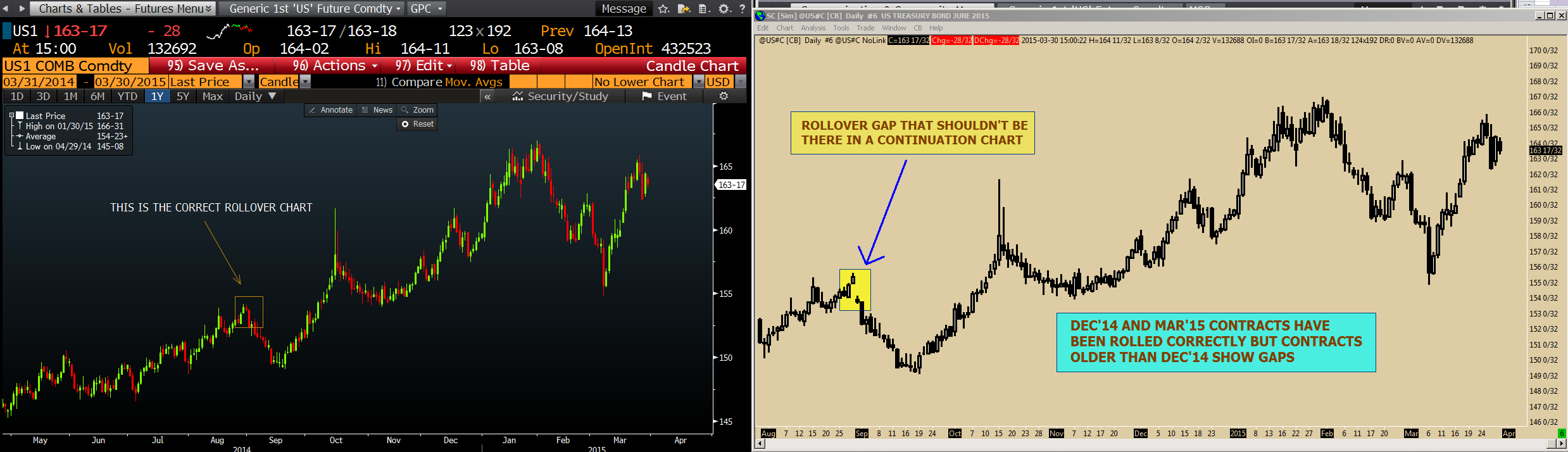

I'm seeing gaps on rollover dates in futures charts using IQ Feed even though I'm using the correct adjusted continuation series symbol. For eg., for the Bond Futures contract I'm using @US#C. Adjustment seems to be correct for rollover Z4->H5 and H5->M5, but there are gaps for rollovers prior to that (pls see attachment). I've attached the adjusted continuous bond contract chart from Bloomberg for comparison.
Thanks in advance for your help re: this.

[2015-03-30 21:56:02]
Contact IQ Feed about this.
Also it is pointless using the Sierra Chart Continuous Futures Contract option with this symbol because it does nothing. It should be disabled.
It is possible due to data errors the data is getting filtered out. Therefore, disable the error filter as documented here:
http://www.sierrachart.com/index.php?page=doc/doc_ErrorFilter.html#DisablingErrorFiltering
After this is done, re-download the data with Edit >> Delete All Data and Download.

buylosellhi - Posts: 60
Disabling error filtering did it - thanks !
