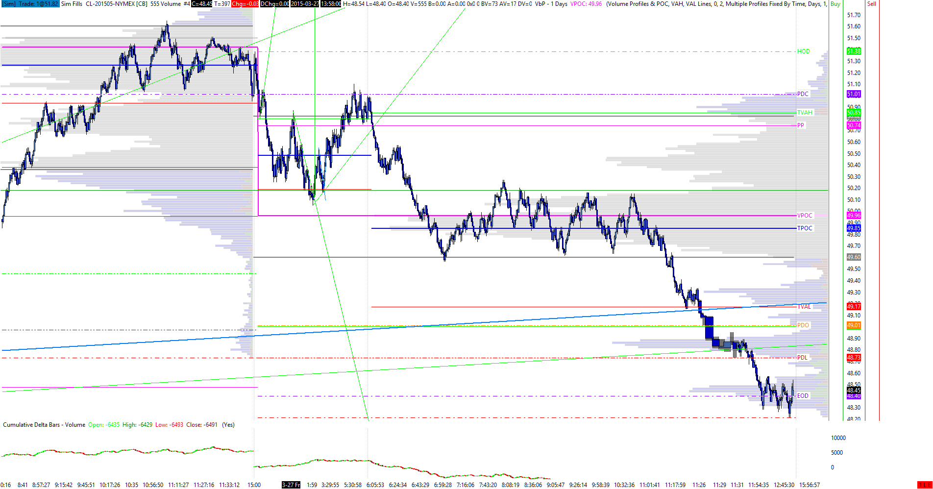

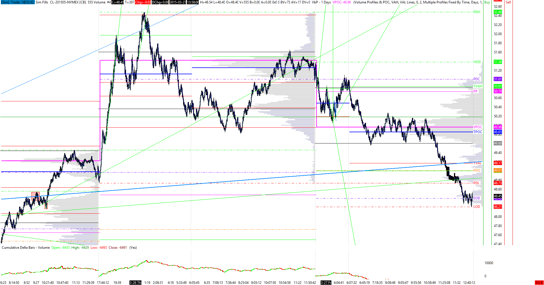

Sorry, title got clipped when I used quote chars. The strangeness is seen when using window width for max bar width type and right align. At max zoom out part of the final VbP is missing.
Attachment 1 showing one level in from max zoom out, and attachment 2 showing max zoom out (where the problem is seen [part of the VP just disappears]).
Maximum volume bar width type: window width
Right align: true
Always keep in view: true
Always align to right: false

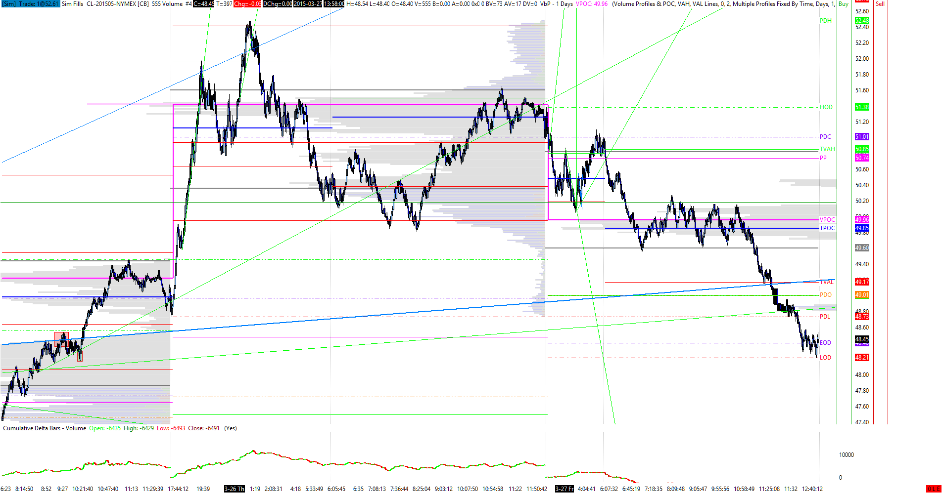

Attachment 3 showing maximum volume bar width: period length (which works correctly at any zoom level).
Left justify seems to work in all modes.
