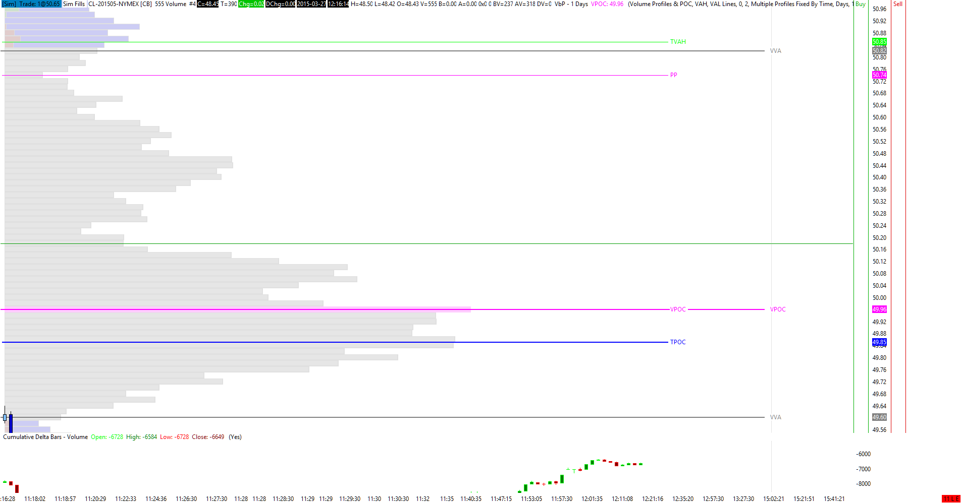

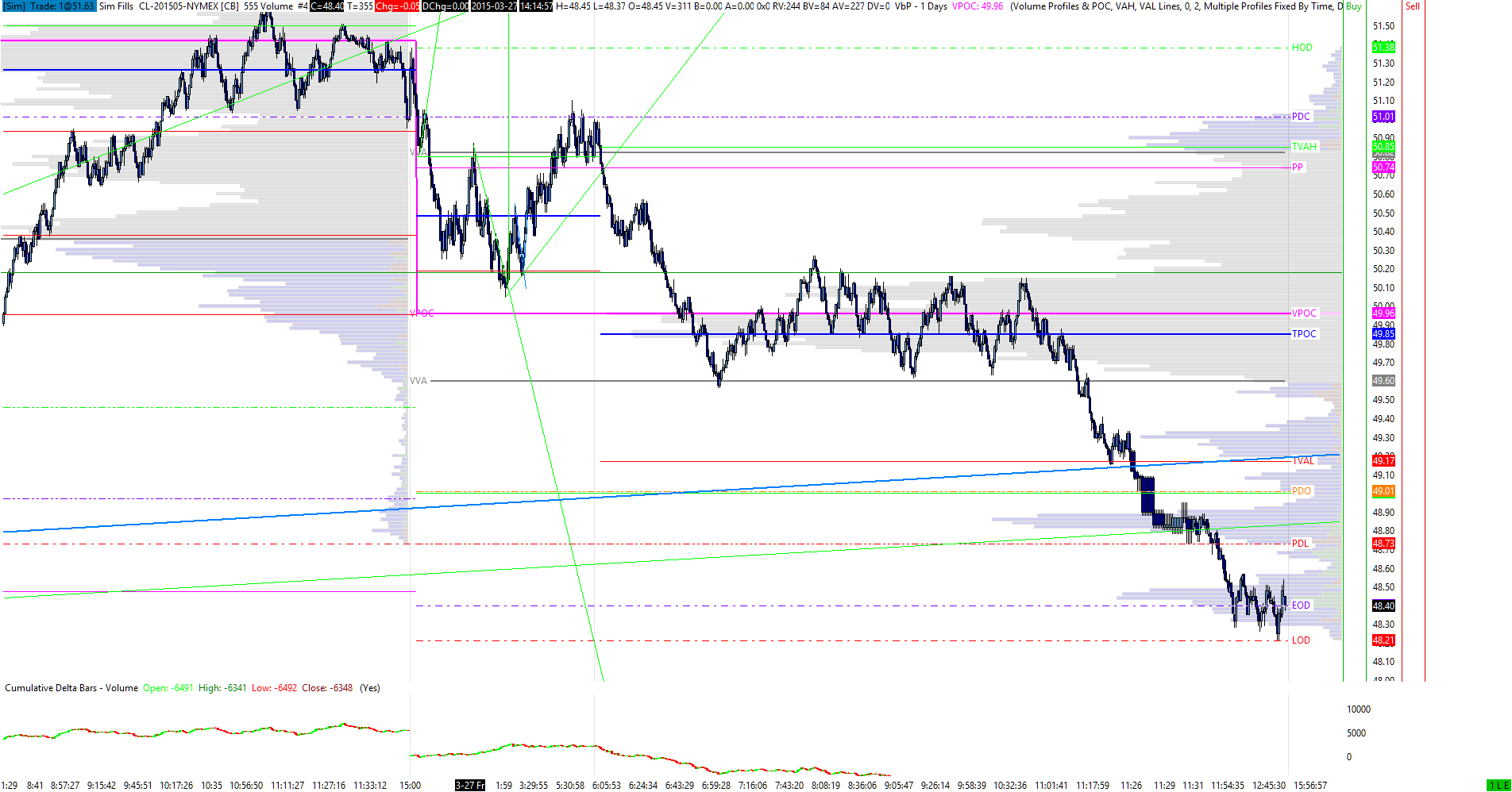

1. Name label for POC duplicated twice if using end of period or end of window (none and future intersect seem to do the right thing).
2. Using any offset with multiple VbP periods on the same chart results in the beginning of the line gapping up or down almost as if they're entirely connected from period to period.
3. Using right alignment mode results in the name labels always being on the left side for the value area lines and for POC it partially works, but if one uses end of window or end of period, it's duped on the left (similar to issue 1).
I'm only using offset to provide a bit of whitespace padding between the line label and the current price edge / end of the line. If there were a general setting for just this type of label offset I'd prefer to use it rather than a study offset as the latter is shifting the entire study. Alternatively if an alternative offset or extension just extended the end of a line rather than the beginning that would achieve the same goal.
