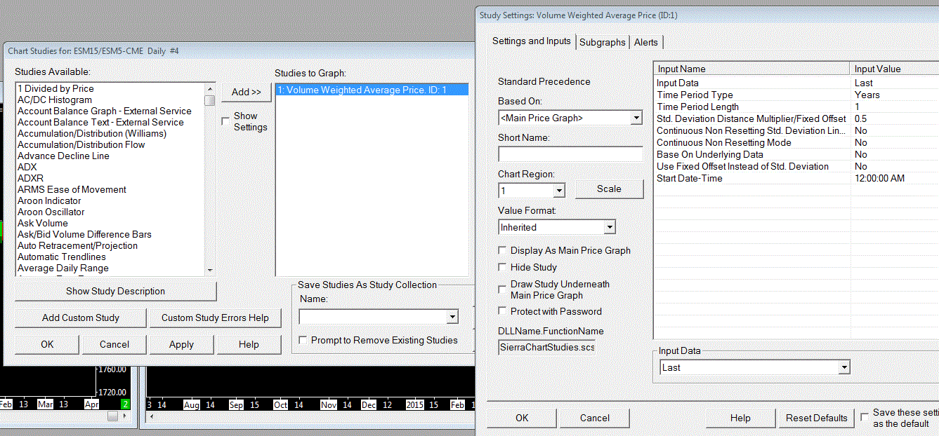

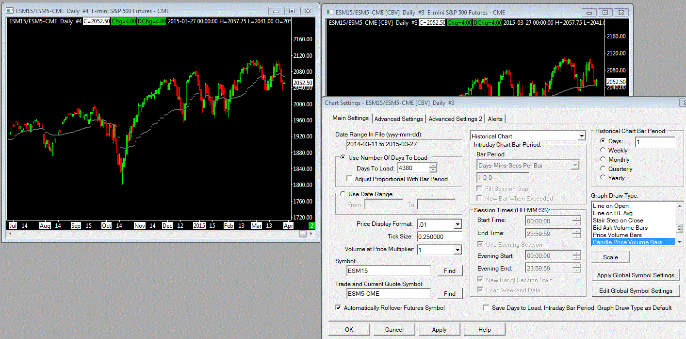

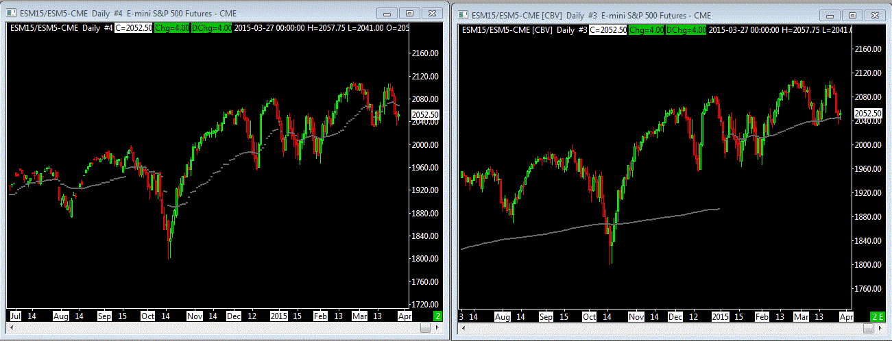

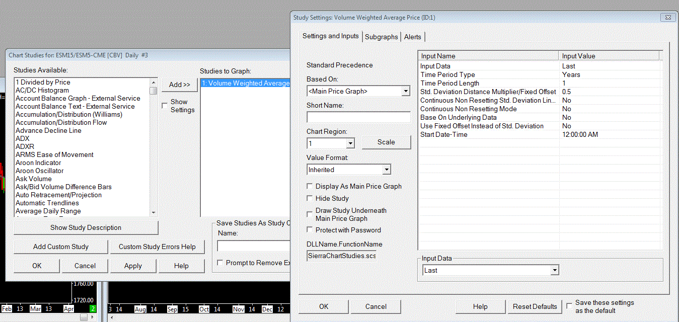

I noticed that my VWAP on my ES chart in one of my chart books is different with another. This is a big problem because the settings are identical!
I saved the VWAP settings in one of the charts, then i duplicated it to the next chart and the value is not the same.
-As a side test i duplicated chart 3 and 4 and gave them new vwaps . They are still printing different vwaps.
-Another test i did is open a brand new chart with the same settings. My vwap reading was identical to chart 4
So what reading am i getting with chart 3? This irritates me because i was obliviously trading off chart 3 !

imagechart 3 settings.GIF / V - Attached On 2015-03-28 23:32:52 UTC - Size: 222.84 KB - 558 views
imagechart 4 settings.GIF / V - Attached On 2015-03-28 23:33:00 UTC - Size: 221.28 KB - 479 views
imagecharts..GIF / V - Attached On 2015-03-28 23:33:16 UTC - Size: 60.76 KB - 467 views
imagechart 3.GIF / V - Attached On 2015-03-28 23:33:32 UTC - Size: 190.74 KB - 462 views
imagechart 4.GIF / V - Attached On 2015-03-28 23:33:45 UTC - Size: 180.72 KB - 439 views

Ok. So i realized that chartbook 3 is set at ( Continuous Futures Contract - Volume Based Rollover, Back Adjusted )
I guess my question is. Does this setting make the vwap's mathematical calculation invalid? How can we get a accurate yearly vwap reading?
Date Time Of Last Edit: 2015-03-29 14:49:31
[2015-03-30 07:27:37]
In our opinion back adjusting will give you invalid values. So do not use one of the back adjustment options for the Continuous Futures Contract chart setting.
