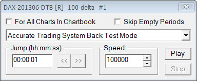

when doing backtesting with the auto trade replay, does the jumps in minutes or seconds make a difference when my algo is based on delta bars vs. using 5 min bars or 500 contracts volume bars?
would it be better do the jumps in 1 seconds X speed of 100000 vs. jumps of 1 minute X speed of 10000?
thanks

User32496 - Posts: 26
i am referring to this image
i want to back test based on 3000 delta bars
so i need to set it as in here?
when the speed is 100000 it make the calculation after aggregating all ticks for 100000 seconds?

Please read the documentation for the Replay Window for information about that setting. And for further help you need to have a paid account.
You have a misunderstanding of what that setting is for. It is completely unrelated to a back testing and is not even used while the replay is running.
