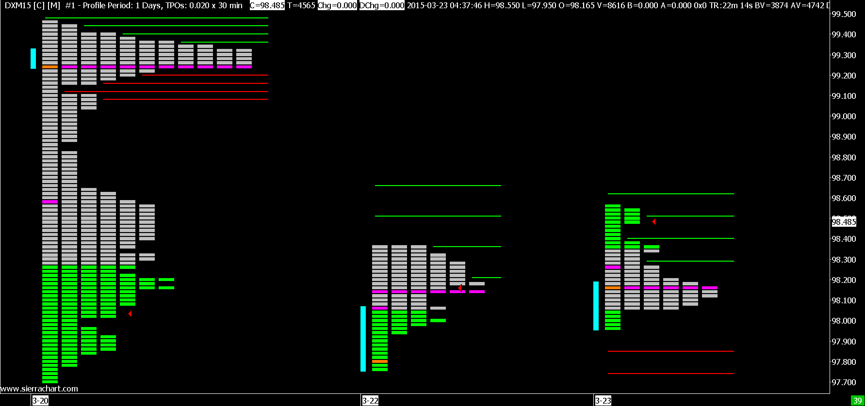

No problems. It is fast for us when scrolling this chart:
http://www.sierrachart.com/image.php?l=1427100842439.png
Are there any other studies on the chart and do you have any Chart Drawings on the chart. You can check for the chart drawings through Tools >> Manage Chart Drawings.
