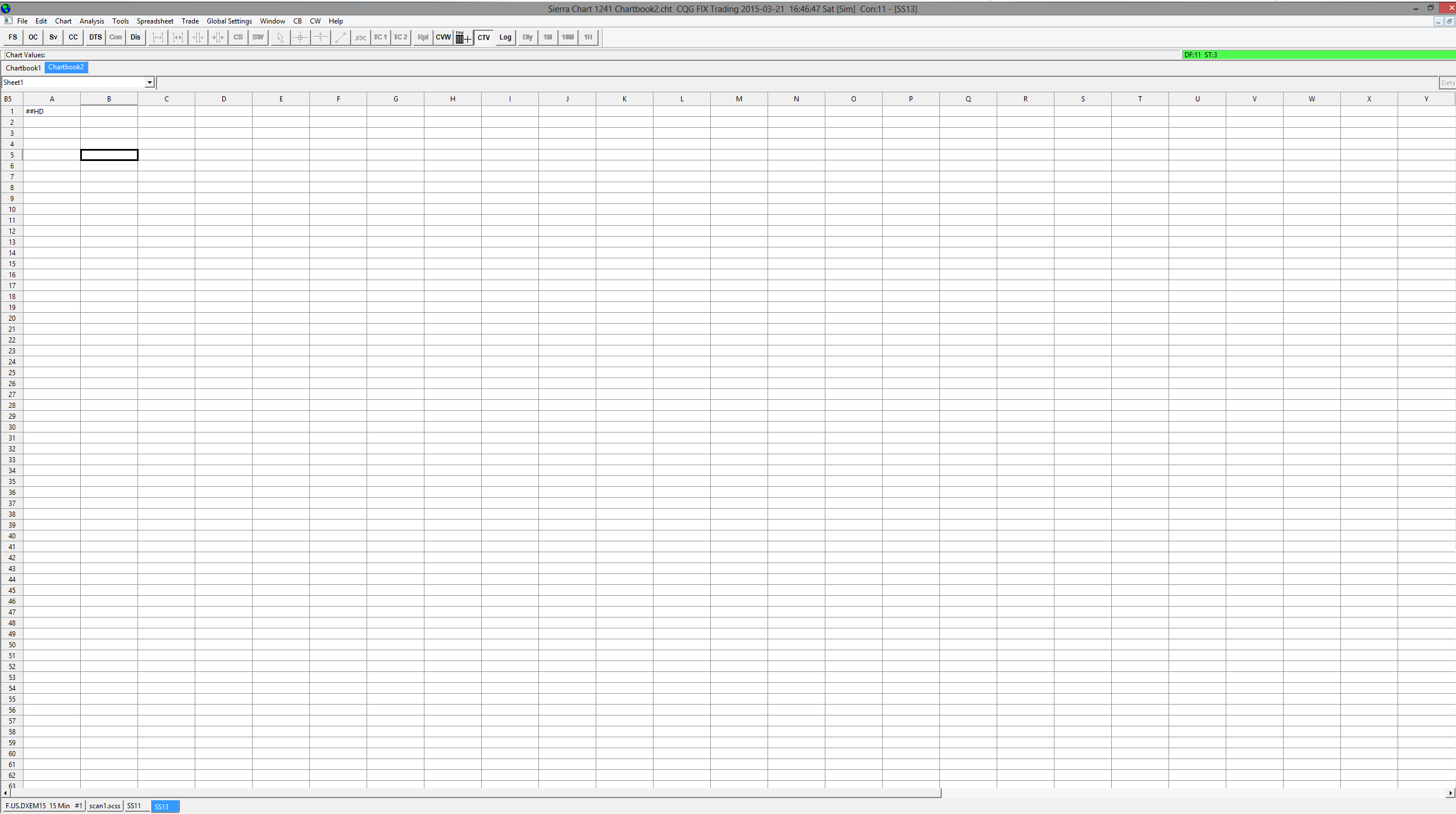

I'm on the latest version of SC (New Spreadsheets), I have created a new spreadsheet and followed this instruction given by Sierra:
"Go to cell A1 on a sheet in the Spreadsheet and enter ##HD in that cell. This will give you a header line describing each quote column."
When I do this, nothing happens, per the attached screenshot.
I have instead tried turning it into a quote spreadsheet using the right click and choosing quote spreadsheet but this has the problem of turning all sheets in the spreadsheet into quote spreadsheets, which I do not want.
Can you tell me what I am doing wrong please ?
imageScreen Shot 2015-03-21 at 16.46.39.png / V - Attached On 2015-03-21 08:47:25 UTC - Size: 122.5 KB - 416 views
[2015-03-23 09:09:41]
##HD is for Old Spreadsheets and we need to update the documentation. This will be done later today.
You do need to set it to be a Quote Spreadsheet which will do this for all Sheets. But we will see if we can limit that.
