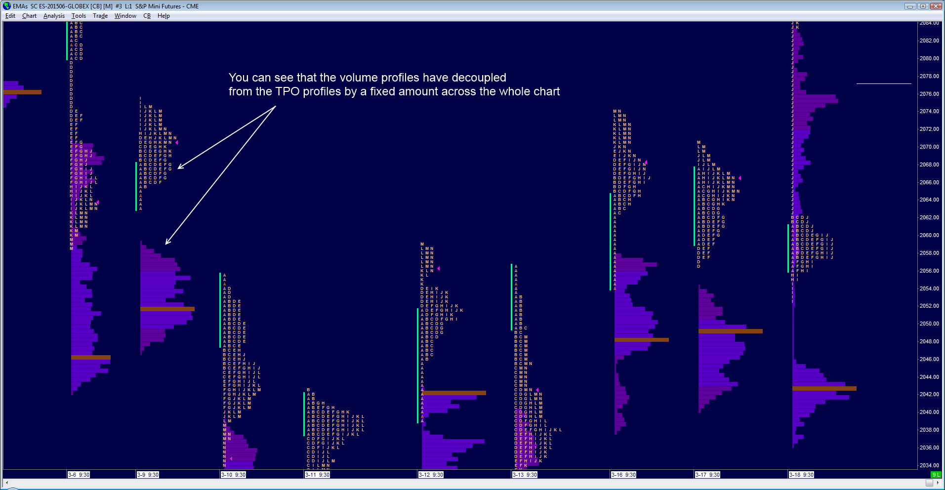

Thanks for the quick reply. On your suggestion I investigated the scale settings for the studies. It appears that this only occurs when the TPO study scale settings are Constant Range AND with auto-centre OFF. The VBP scale is left on 'automatic'.
If the chart is displaying TPO's and Volume profiles together that extend above or below the visible chart area and I try to move the chart forwards or backwards in time by one increment (the default for the left and right arrow keys / mousewheel) then that causes the misalignment. It also happens any time I make any adjustment to any study on the chart and press apply in the chart studies window.
I've included two pictures (through the attached files since uploading the chart makes the chart recalculate and removes the anomaly). One showing the misalignment, and another to show the chart without any misalignment due to me compressing the scale down to fit everything on the screen at once.
This is probably my fault somehow but I don't know how :(
Thanks so much,
imagetpo vbp anomaly.png / V - Attached On 2015-03-19 03:21:54 UTC - Size: 91.87 KB - 522 views
imagetpo vbp compressed.png / V - Attached On 2015-03-19 03:22:08 UTC - Size: 65.77 KB - 562 views
