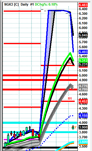

Im sorry please ignore that post, I found the "update chart drawings to current symbol"
but I am still having a problem rolling over, the attachment is pretty self explanatory

Make sure you are on the current version Sierra Chart. If that does not help, then disable Chart >> Chart Settings >>Continuous Futures Contract because the volume data for that symbol is not usable for the method by which this feature uses for rollover.

well i found out that by manually replacing the default symbol of "NGK13" to "NGK3" everytime i open it from the quoteboard it draws correctly, in case anyone else has this problem
is there a way to make this the default so i dont have to change it in chart settings everytime?
