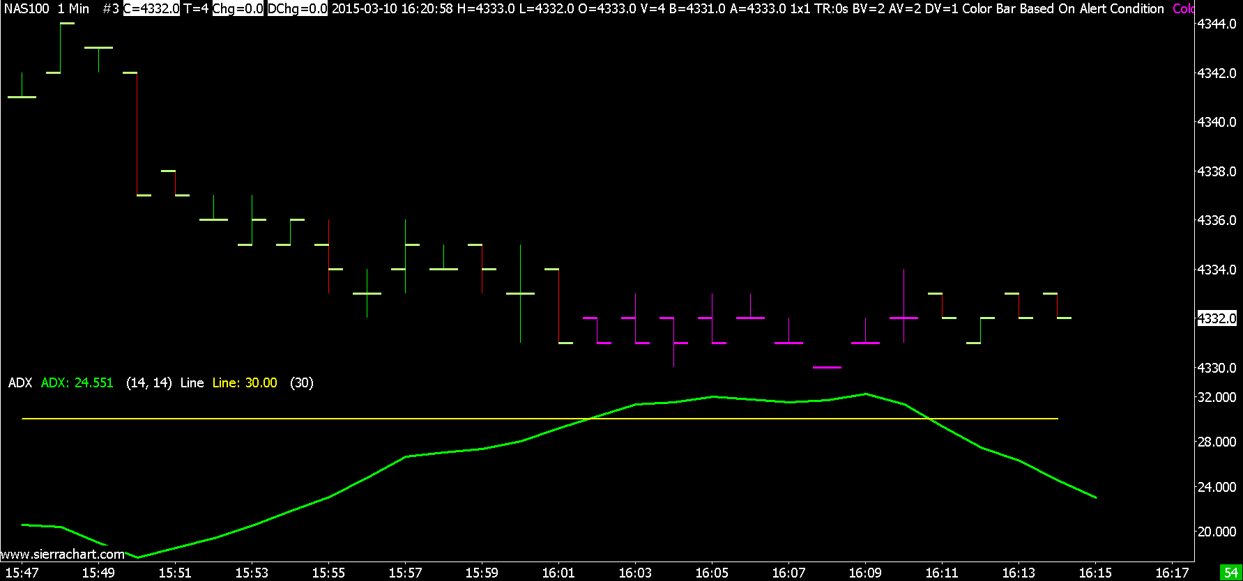

Here is an example of the bars colored when the ADX is over 30:
http://www.sierrachart.com/image.php?l=1426020334983.png
The ADX is displaced forward by 1.
Date Time Of Last Edit: 2015-03-10 20:46:00

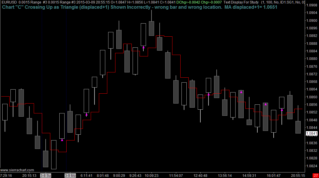

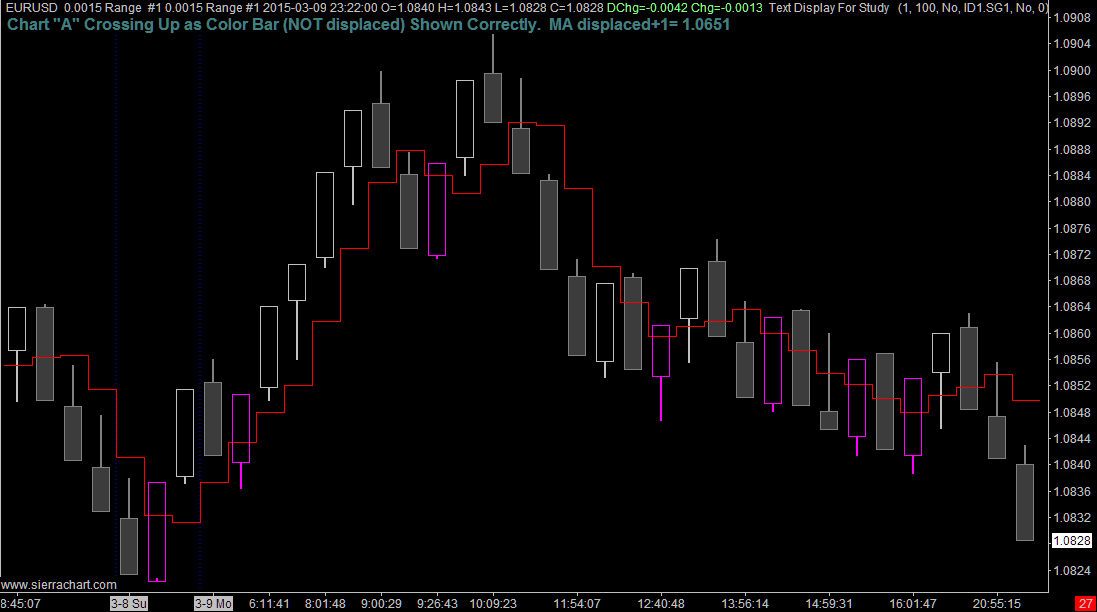

Support, please see attached charts. EURUSD 15 Pip Range Chart, 3 period Simple Moving Average displaced+1 (ID1). Color Bar Based on Alert Condition set to "Based On ID1". Alert code =AND(O<ID1.SG1,C>=ID1.SG1)
Chart "A": Display as Color Bar shown correctly.
Chart "B": Display as Triangle on MA shown in correct bar but at wrong level. Color Bar Study not displaced.
Chart "C": Display as Triangle on MA shown in incorrect bar and at wrong level. Color Bar Study displaced+1.
The objective is to pinpoint the alert correctly with a Triangle display.
I trust you can see the problem now.

[2015-03-18 03:35:11]
We understand the problem now. The Input Data from another study that the Color Bar study is based on, needs to have the displacement applied.
