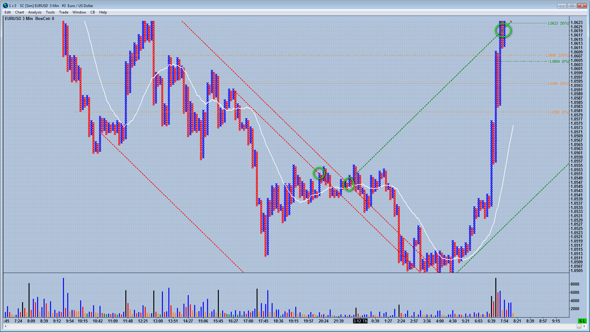

I'm not sure if this is what the above user was saying but as an addition for the Gan Fann, i'd really like the ability to define an end point for the line.
I'm using the gan fann to construct 45 degree trend lines on the P&F chart. It would be nice to have the ability to define the angle but then not have the line go on for infinity. I've attached a chart with a couple of examples. Being able to cut off/end the line at the circled points would be a huge benefit as the trend line has been broken at these points.
I don't know if this is possible but i'd personally find this very beneficial.

KinsaleForex - Posts: 19
Hi michelh, thanks for addressing my question. Unfortunately I can't just use normal trend lines. Point and figure is supposed to be based on a square grid and have 45 degree trend lines. Seeing as the grid isn't square i'm using the gan fan to obtain 45 degree lines, as suggested by Sierra in a different thread. I understand that P&F doesn't represent time.
I'm sure the lines going to infinity is useful for actually using Gann as a style of trading but when we're supposed to use it to just achieve these 45 degree lines (as I am) it's a little unhelpful to have them like this. I'm not saying to remove this feature, but to have the ability to expand the tool so that the user has the option. I'm adding and removing new lines all the time so It's far more useful to be able to draw the lines as shown in the attached image.
Cheers,
KF

[2015-04-14 03:45:09]
Al SC Developer - Posts: 434
In the next version, the Gann fan and grid have new modes that allow the main Gann line to be set with the second mouse click. This new behavior is the default, but the old behavior is also maintained.
Within the tool config, you can not specify how the Value Increment Per Bar is specified (used to be called Value Per Point). The options are to set the value from the second click, use the value from the config, or use the chart value. If you need to use both new and old behavior, then you can configure multiple tool configs and switch between them.
The Gann Fan and Fib Fan can also now be cut at a specific bar (all lines are cut at same point).

[2015-04-20 09:07:32]
I downloaded the prerelease today to give this a try. How do you cut the lines at a specific bar? I can't seem to find it. Thanks.
[2015-04-20 11:26:14]
The Cut Drawing Here command has to be added to your Chart Drawing Shortcut Menu. See http://www.sierrachart.com/index.php?page=doc/doc_Tools.html#CustomizingCDMenu
