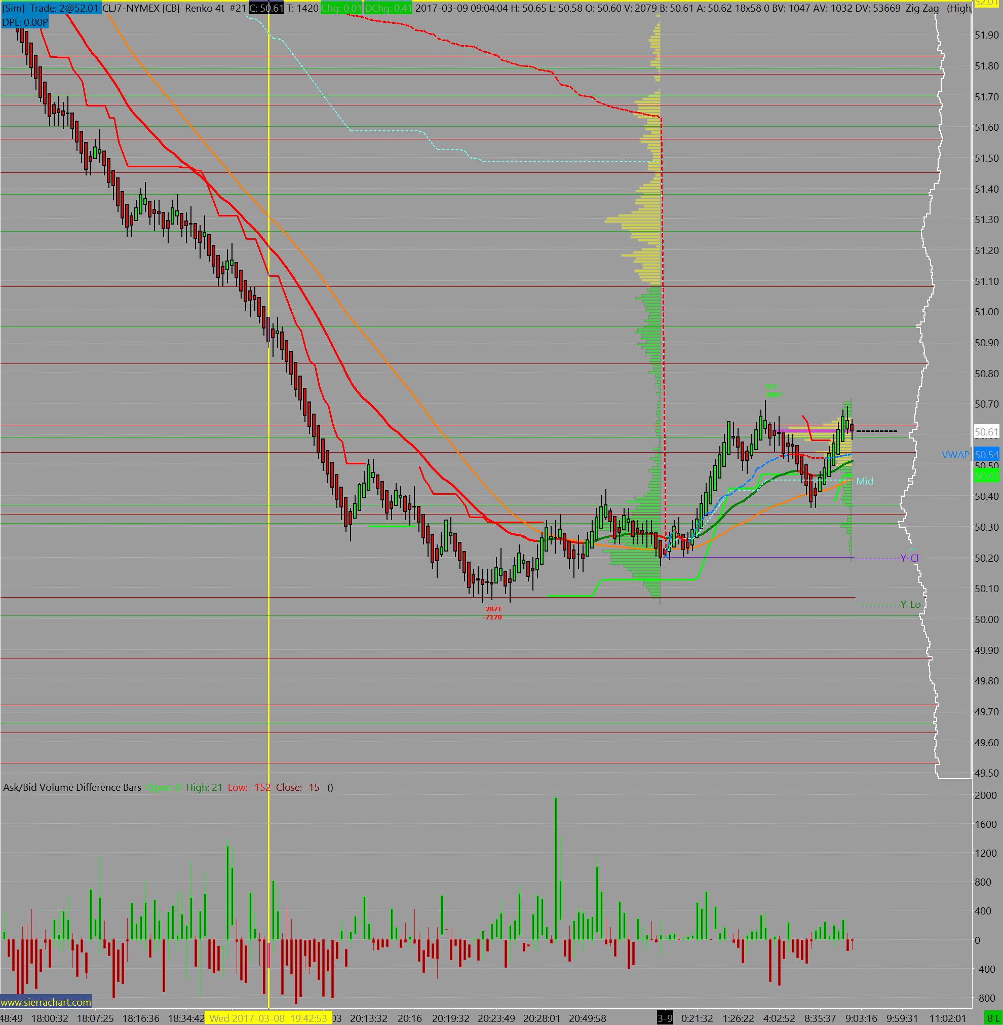

I sent a picture of what I see and still you send me to the same place to look for a solution. I have a composite profile on the far right....
I then have a daily profile (multiple daily profile) My candlesticks sit on top of the profile and no matter what I try I cannot get the profile further right or the candlesticks further left so that the profile is fully visible.http://www.sierrachart.com/image.php?Image=1489046647286.png

User240686 - Posts: 86
OK what you are suggesting puts the profile to the FAR right which means it appears on the y axis within the composite profile. I was trying to get it to sit outside of the composite profile but I cant see how this can be done

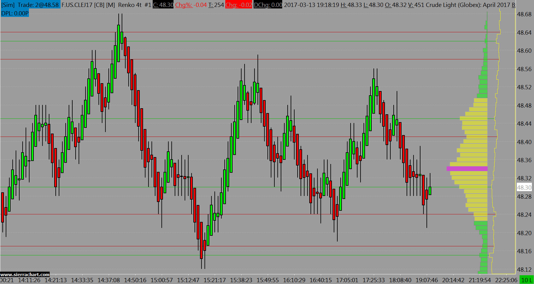

Before we attach the Chartbook, let us know if this is what you want:
http://www.sierrachart.com/image.php?Image=1489429261937.png
[2017-03-14 06:55:54]
yes that is perfect but I could not get it looking like that with the rest of my indicators on the chart
