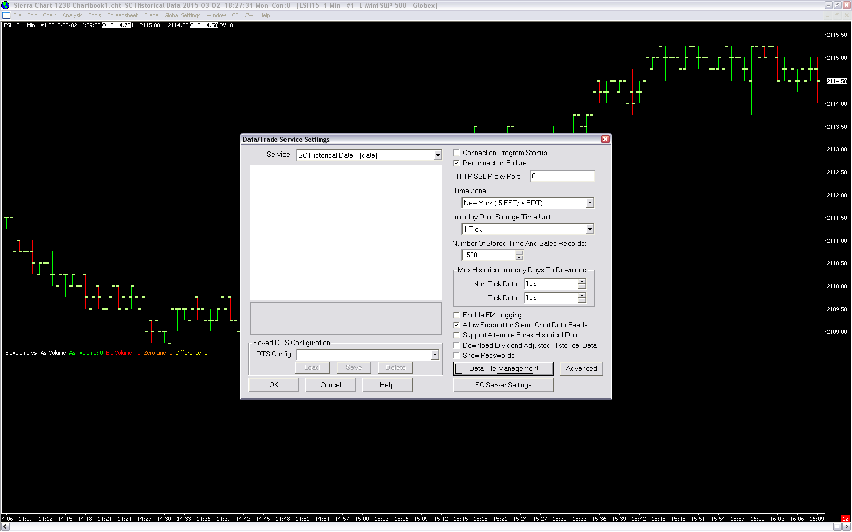

mayerrs - Posts: 70
so i must do something wrong because i have no historical bid vol and ask vol. when i use study BidVolume vs AskVolume there is just 0. and i believe i set everything right. i have set SC Historical Data and intraday data storage time unit is 1 tick.
see the pic

[2015-03-02 23:53:18]
Perform a Full Reset of the Symbol Settings as explained here:
http://www.sierrachart.com/index.php?page=doc/doc_GlobalSymbolSettings.php#FullResetSymbolSettingsSteps
After re-download the data in the chart with Edit >> Delete All Data and Download.
